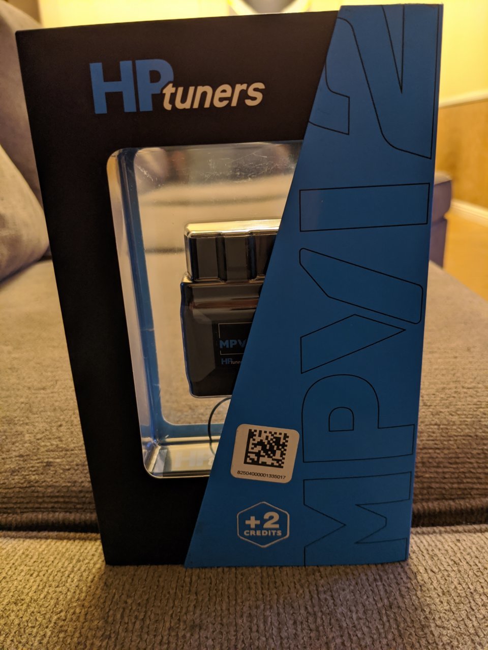

  14. Dec 5, 2019 at 8:18 PM
    XPOTRPR
    XPOTRPR CNC Programmer/Machinist
    May 29, 2011
    #57449
    31,168
    Josh
    Chandler, AZ
    > BUILD LINKS >
    Truck is back at the shop... Just as this showed up.

  16. Dec 5, 2019 at 9:39 PM
    XPOTRPR
    May 29, 2011
    #57449
    31,168
    Josh
    Chandler, AZ
    > BUILD LINKS >
    Funny thing is... This showed up when we got back from dropping it back off. :rolleyes: if done correctly the first time.. the timing would have been perfect. Lol.
    Took it back. He immediately worked with me and talked about the issues. I stayed calm and gave them their chance. Went out and I personally showed and went over all my concerns. Both crawled under the truck and he was surprised how bad the work was. We talked and came up with a game plan. It's all going to be covered by them, and now they are building me a whole new y pipe with vibrant flanges and gaskets, he's personally going to work on the truck and weld up everything. As far as the blower lid and bolts, he's taking it all apart again and doing every one of them this time. I'm trying to stay positive and give them the benefit of the doubt.. but if it's shit again when I pick it up, I'll have no choice but to take action.
    Surprising... Because I've seen their work and the cars they build/tune. My shitbox is the cheapest thing there most of the time. We'll see..
