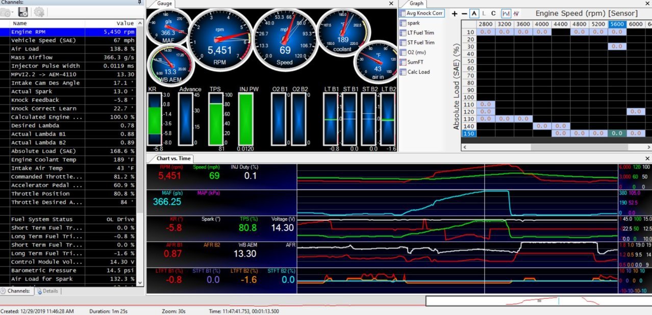

    Finally able to rev it up a little as the tune is getting closer to right and I feel more comfortable pushing it some (big thanks to @JustDSM ). Maxed out my maf sensor as low as 5450rpm. Prior to the engine work- I didn't hit this till ~57xx rpm. As for boost- i'm able to hit 8 currently might get 9 on an extra cold day. Time to look into re-scaling the maf sensor numbers again.log pic.jpg

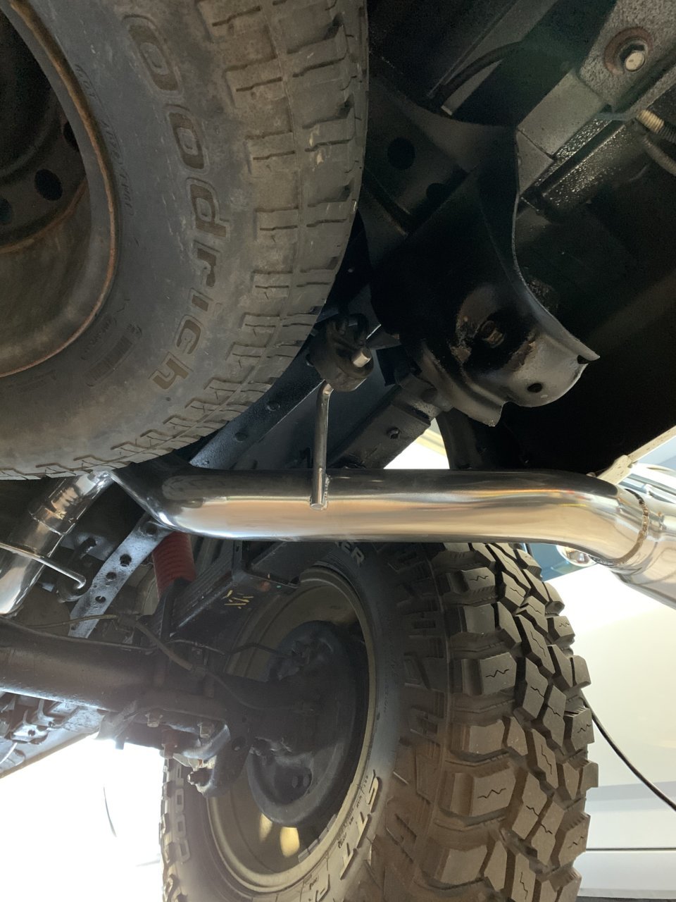

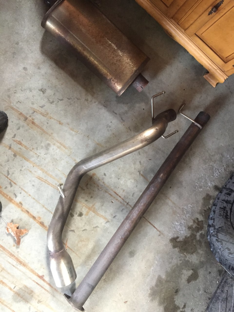

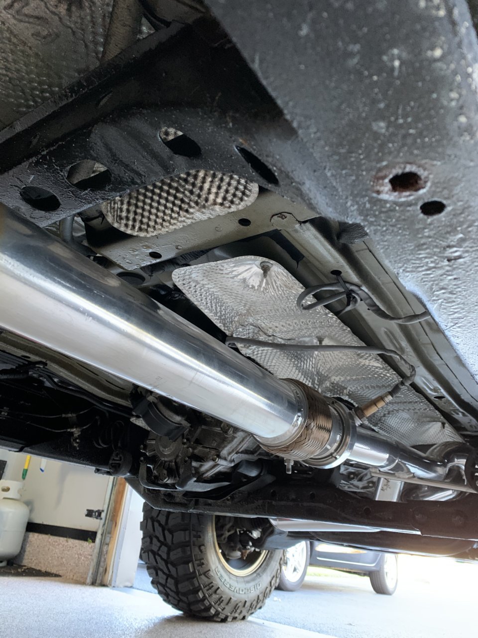

    You’ll like that too. I did the same about a month and a half ago. C352B1DA-2DB0-400E-8FF2-0B4BF756AD1B.jpg 37A69B00-0223-46EA-8C14-82CE2D93156C.jpg 53F5C7E7-3F93-4D67-B346-DC2999071F5B.jpg
