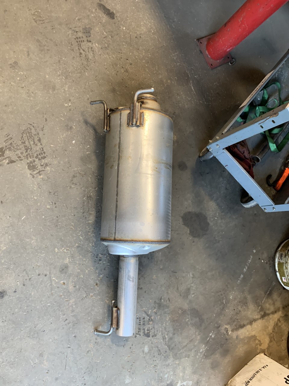

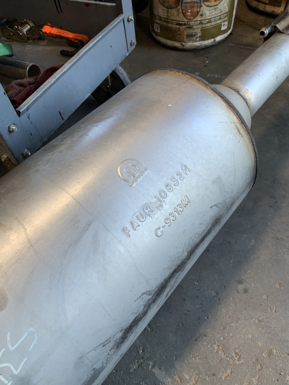

    Yes
    Just pulled up to the exhaust shop, and what are the odds that they were cutting the OEM muffler off a 2019 RAM as I got there.
    If I’m wanting to keep exhaust note minimal, with increased flow over factory, this’ll do the trick? It’s either this or a large body magnaflow. Muffler guy is saying he thinks the Dodge one may be too restrictive. 2.85” pulley, aFe intake with TRD SC tune currently. Plan on HPT down the road but power is really not a priority currently. Have about an hour to decide. Plan is 2.5” y-pipe to 3” v-band then 3” the rest of the way back with the RAM or Magnaflow muf, dumping over the axle.

    That’s the one. It is 3” in and out for a truck designed stock at around 400hp. I’ve got mine in the garage still until I can mock it up with my JFR Y all at once.

    Fuck it I’m gonna give it a shot. Worst case I swap it out with a magna down the road but I think I’ll be happy with it.

    what's the diameter of that muffler? wonder if i can even fit one with my trac bar in.
