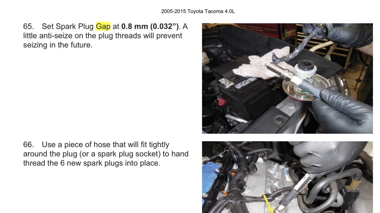

    Hey, what’re you guys gapping the IKH-24 plugs to?

    You don't. They come pregapped to .39-.40 don't touch them.

    Magnuson supercharger Install Manual says 0.8mm for the included plugs. I gapped my IKH-24 plugs to 0.8mm also.

    Many plugs do come pre-gapped. From personal experience installing likely more than 1000 plugs in my lifetime, I recommend you ALWAYS check the gap on each plug before I install it on ANY engine.
    Out of the six IKH-24 plugs, I installed just a week or two ago, two of them the gaps were too tight.

    Yeah, I remember gapping the plugs when I installed the Supercharger. I also remember fixing a couple now that I think about it.

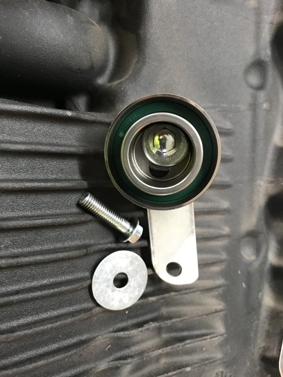

    BTW @loginfailed , thanks again for the heads up on this :thumbsup:

    Nice! :drool:
    But that one was supposed to be for me!!!

    I know. I didn’t even hesitate a bit when I heard this :D
