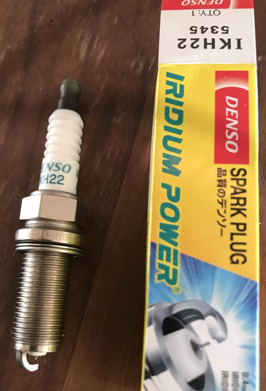

    Got some new plugs the other day. Thought these maybe fake from the new packaging but looks like they started this new design 2018. Nowadays you gotta check the real from the fakes.:rolleyes:

    I get mine through URD. They have pretty good prices and I trust them not to be knock offs from them

    That’s what mine looked like when I got them the other day and installed them

    I got these from my local Napa store. They were 9.60 a piece and no waiting for shipment

    That packaging is nothing new. That's how mine have been looking since 2015 actually.
    That is good to know! I always struggle finding these locally and I usually have to wait for the plugs to be shipped in from another store or location from the one I am buying them from. The NGK ones for me seem to be a lot more accessible than Denso so it works out for me either way.
