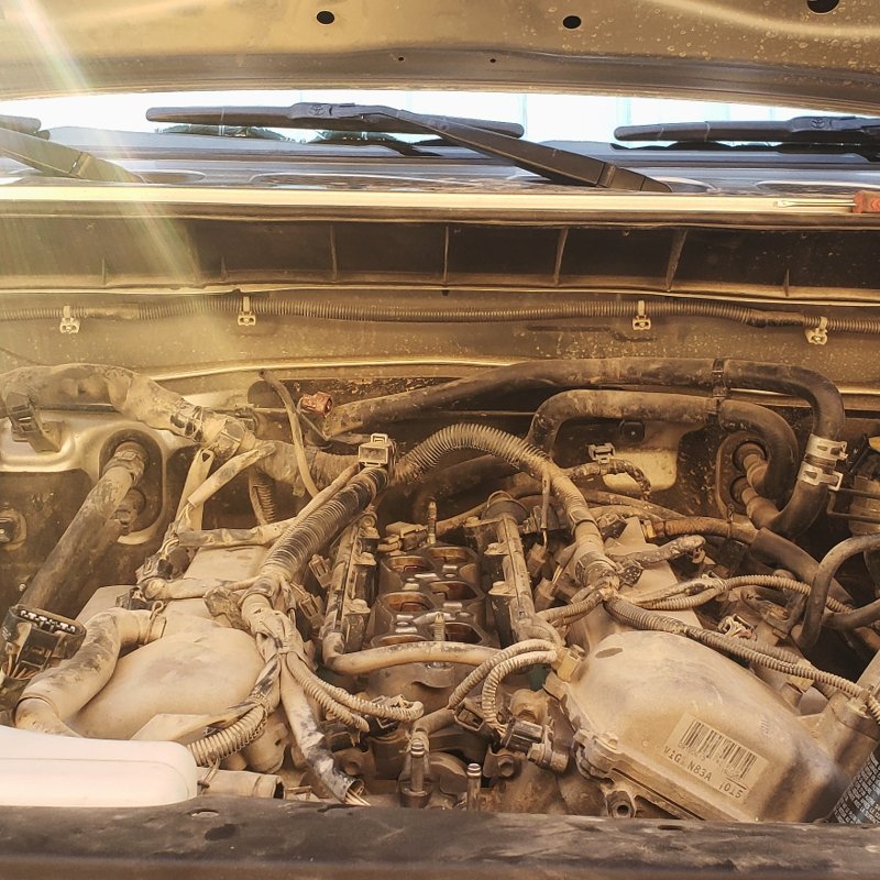

    Diving in. But first exhaust cam gears

    Giddy up, definitely tape over that intake. You got some serious mud or dirt it looks like in the engine bay.

    I had tape on there but no tape looked better.. for the 'gram! My bay collected that over the past couple years. I only ever washed the outside exterior cover then I stopped when skid plates did nothing for stopping the elements. Then I have hood vents that don't help either....
