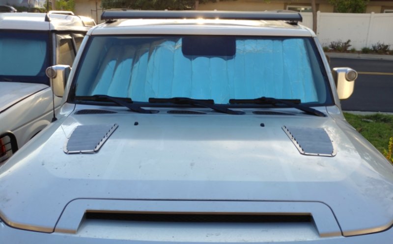

    That looks slick! Although what do you do for wet weather?

    that is exactly what i wanted to do. brz/ toyota 86 louvers?

    Nothing. It just drips in and washes that section of the engine bay. Won’t hurt anything

    It reduced temps but thanks! ;)
    If I lived in snow climates, I'd bolt in the original cut outs I made. I still have them but been lazy. Skid plates don't help much in splashing water. Engine bay gets pretty wet underneath since she's a daily.
    I can't afford that JDM stuff. Some of their louvers are nice but wasn't looking to spend 125+ for a single layer CNC piece. These are Simpson offroad vents and 2 piece sandwiched on the cutout. I guess the owner was waiting on getting a table to make more but no news and their website is out

    ah that make sense. Funny enough his picture on his sight is soaking wet from rain. I guess it would not be as bad with the vent cover over them.

    No inner fenders and I haven’t had any issues with snow or wet conditions this season and I guarantee the lack of fenders throws more water around the engine bay than the louvers

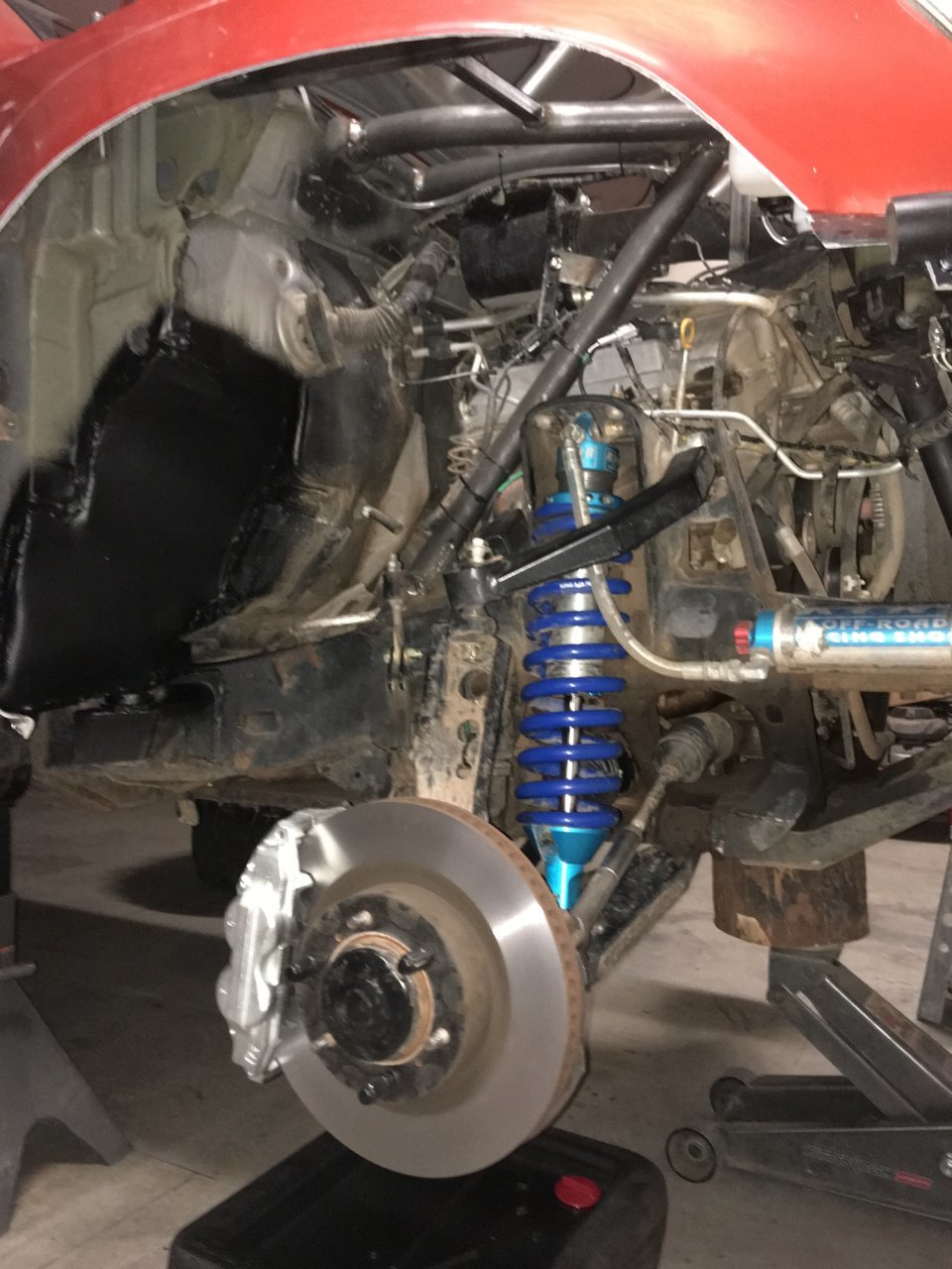

    I have Dakar’s now and just did a relocate. The Dakar’s are stiff on all the bumps. The extra leafs in the Deaver I hear soak it up better. You can get Deavers for any weight handling. My buddy has a setup for 1000lbs over stock. He switched from a Dakar setup and loves it. If your going all out in the rear upgrade the springs. Next suspension upgrade is new springs.
    My recent Rear change
