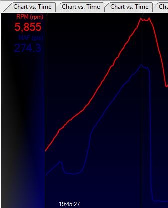

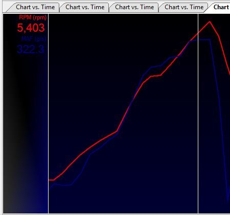

    I am glad to hear from you that switching out to the 3.5 intake was remedy for the otherwise lean conditions at WOT. It's nice to see I picked up some boost in the process as well. :)

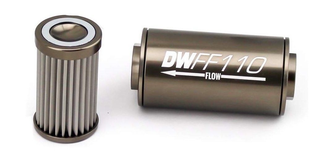

    This is our mounting location for the FST. On @Lucario Runner 's Tacoma.
    (The Radium fuel lines fit perfectly, but unfortunately did not get any pictures of that.)
    Reattached to the OEM fuel lines.

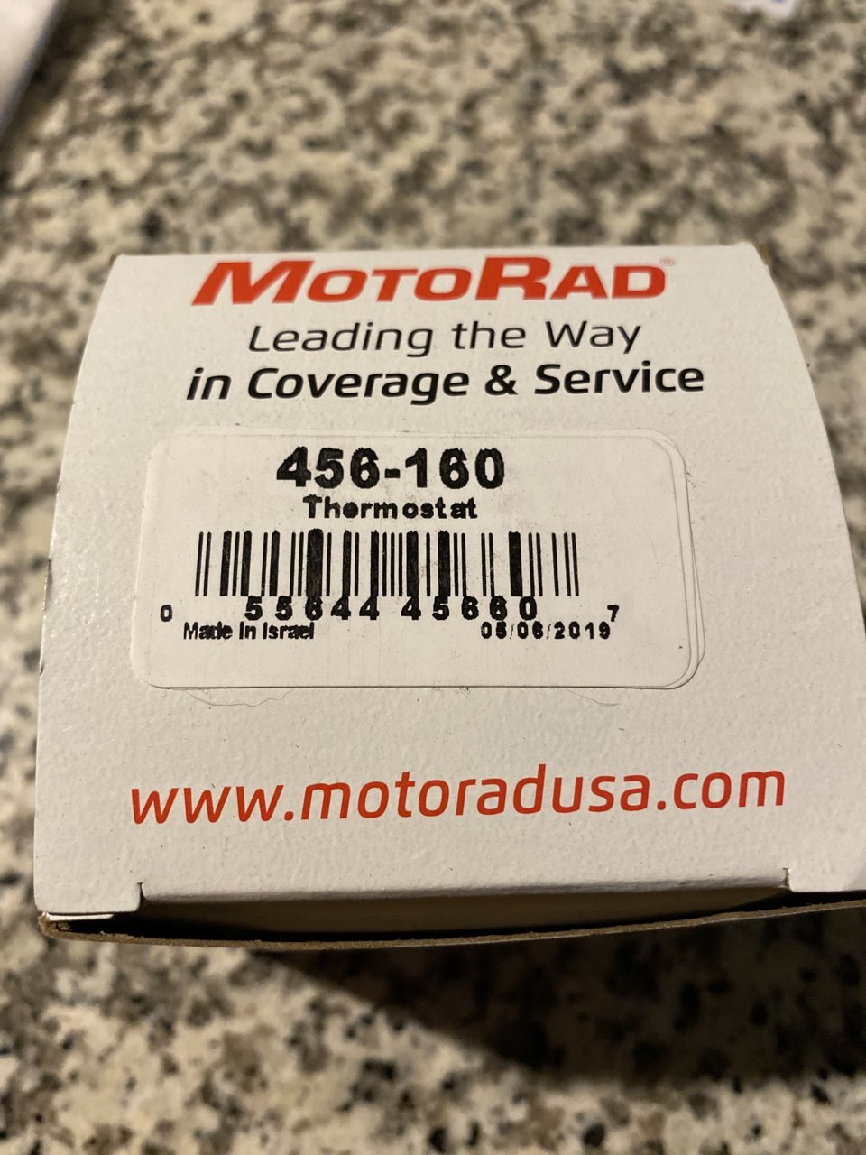

    What type 160 thermostat did the ucon come with? @Torspd you remember?

    Thought it came with 170?

    It does. The Motorad 160 is what a lot of folks used with the kit.

    The only stampings or otherwise indicators to what is in the URD Kit is “USA” and “56mm”
    The MotoRad 160°

    Unfortunately in your case no sir. The issue @12TRDTacoma was facing was a bit different than what you're facing.
    @12TRDTacoma was maxing out his MAF as evidenced by the flatline as RPM's continue to rise (and the fact the logged MAF voltage is 5.00v)
    Your truck isn't quite pegging the MAF yet.
    I do think it would be interesting to see what would happen on your setup though. If you'd like to try the 3.5" setup, I'll be more than happy to take care of the MAF re-calibration.
