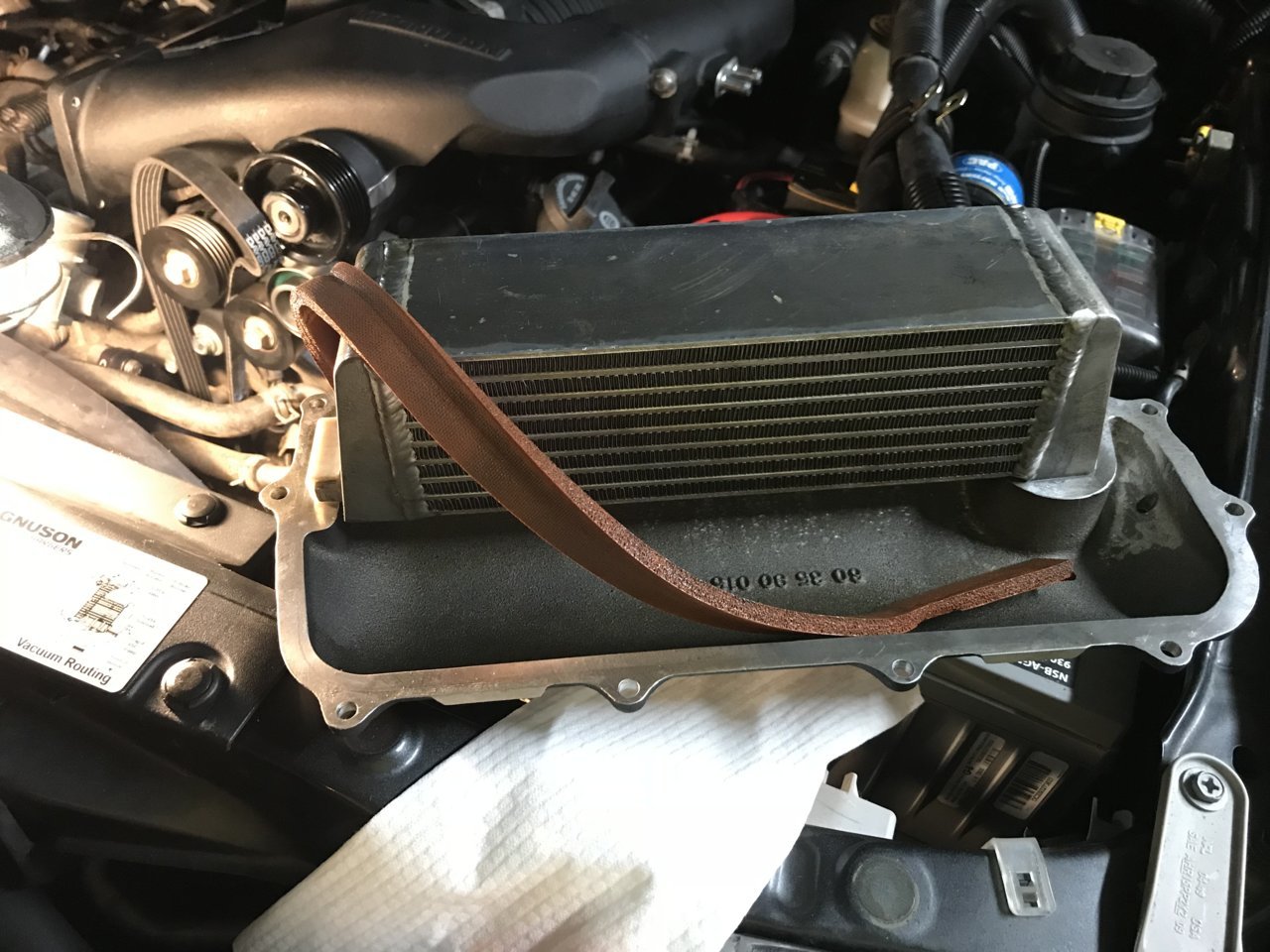

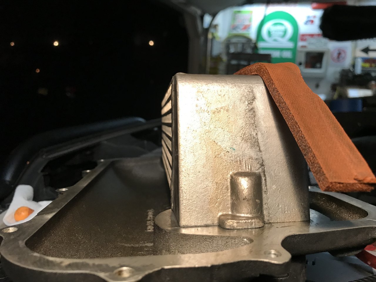

    So, what do I do about this? Just hold it in place as I drop it it? I have horrible visions of of the gasket being sucked into the intake...

    Some people don't run it, I personally run it and siliconed it in place so it wouldn't move.

    OK, thank you. It has oil all over it. I don’t think I’ll ever get it to stick with silicone. I think I’m just going to set it aside for now and address it later.
    See if I can get a clean replacement and put it back in some other time.

    You definitely want to run it! Without it some air will bypass the intercooler so you will have hotter air entering the engine. I used this on mine.15223748658258201584114475952711.jpg
