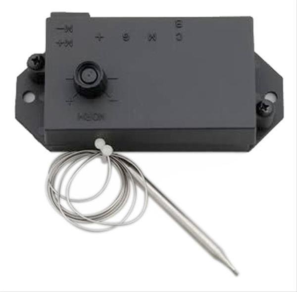

    I'm concerned about the thermo fan switch that is a blade type and sits in between the fins. I want to switch that to a coolant hose adapter type but not sure if it's as easy as soldering a new wire/thermo switch.

    maybe connect it and t-tap to an alternate temp sensor. even if its not in a coolant pipe it may confirm an alternate reading potential. just an idea.

    The thermal probe wiring is solid exposed. I plan to de-solder it from the box and do a coolant thermo probe instead.

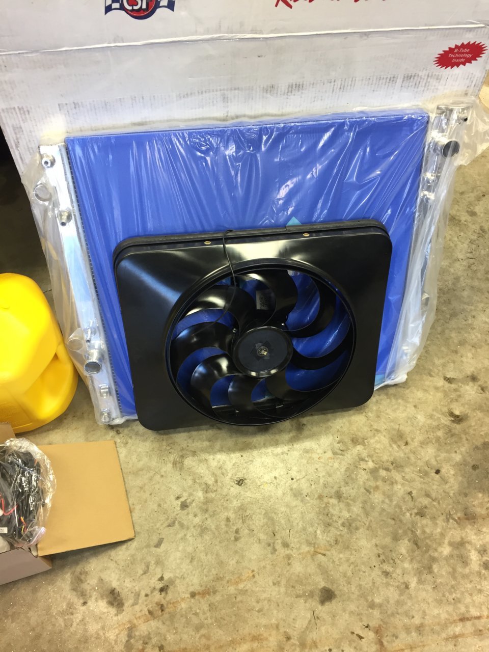

    Csf for fj and flex a lite. Haha it’s a little smaller...426E59D0-5AF2-4E8A-81CF-702C4CF09AE1.jpg

    Damn, that is a lot smaller than I expected. Are you gonna just send it like that or are you gonna try and mount it to the oem sized shroud?

    Perfect fit. :anonymous: :burp:

    the obvious solution is to cut down the radiator to fit the shroud.

    Probly just center it and then mount about 20 computer fans around the remaining part. :anonymous:
    I dunno yet. I’ll have to mess around and see. I have my stock shroud I can cut up or get an fj one and cut that up. Have plenty of time.

    That looks like a fantastic way to blow your brand new engine.
