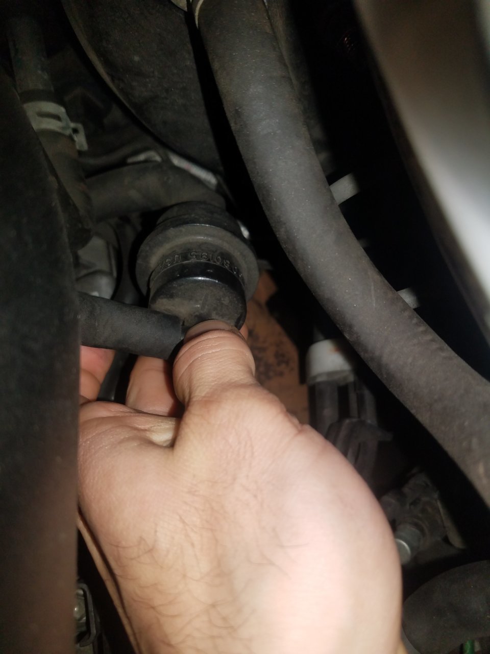

    Wanted to revisit an old inquiry from a while ago.
    We got into a conversation about catch cans (no I am not getting into one) and I noted that I do not run one but I do, however, run an inline air/ oil separator valve between the PCV valve and the supercharger. Some of you inquired to know more about it but I had no part number or further info for it at the time. I revisited the topic again because I personally wanted to know myself as it had been THAT long ago. Here you go.
    Dorman HELP! 80195 Power Brake Filter Gm

    I don’t see how this small brake power booster part could possibly work for filtering clean air. Brake fluid is a completely different animal than the oil a catch can collects. When a catch can is installed properly with a TRD blower then it usually will collect about 3 oz every 5k miles.
    I don’t know. I like a clean inner cooler that’s oil residue free and my catch achieves that :thumbsup:

    There never was any brake fluid attempting to go through it. It was designed for early EFI and late model carburetor equipped GM vehicles.
    It may not catch it all for me, I'll never know until I open up the interior of the blower to know, but it is there more as a small safeguard outside of going a full blown catch can setup for me and that alone is more than enough to make me happy.
    This is more for folks who don't want to run a full on catch setup, but want some sort of level of vapor inhalation prevention protection and want more of an "OE solution" style looking appearance for when it comes to smog inspection time. They may see it, but will not even bat an eye at it.

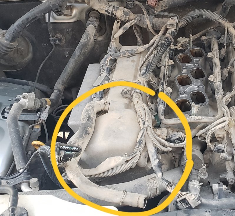

    Most people don't because they don't remove the intake plenum and see both valve covers have a a vent. Just thought maybe the guys here have. Though the passenger side one does not have a PCV and more of a breather port. I use cheap Chinese ones because most of the catch cans are coming out of there.

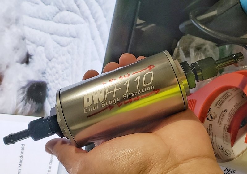

    If I could afford the expensive stuff, I would have. The cheaper ones need a bit of fixing, cleaning the rough ports and I added some stainless steel scrubber material to catch the oil vapors. A stainless mesh would work too. If the weather gets better, I plan on installing my s/c this week. Got my Ur.d ucon back from reconfig and deatschwerks fuel filter with AN fittings.

    When the engine is running, both valve covers do not vent, with all hoses properly attached per OE specification. The passenger side is the fresh air inlet, for the driver side to be pulled from, into the plastic upper plenum.
