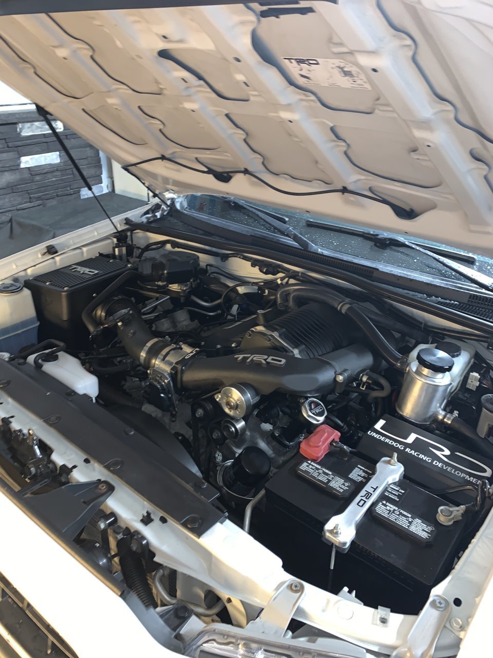

    8D5402C6-13D6-4861-8F69-D764E1E30692.jpg I’m telling you boys.........Figgs is where it at! :rofl:

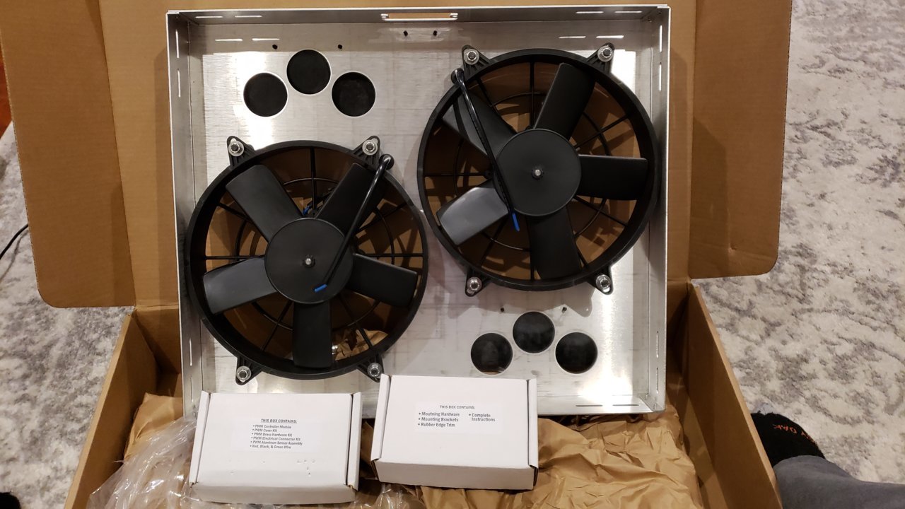

    Nice! Is it custom fit? Where did ya get it from?

    Derale system. Not custom but measured to be the best fit for our radiators. I'll mock it up off of the stock radiator to figure out mounting options
    EDIT: stock radiator is off truck sitting as csf radiator is currently installed

    Even without Figgs, your engine bay is a thing of beauty! :bowdown:

    Thanks man!!..I try.

    those guys do a sexy bay in chi town.
