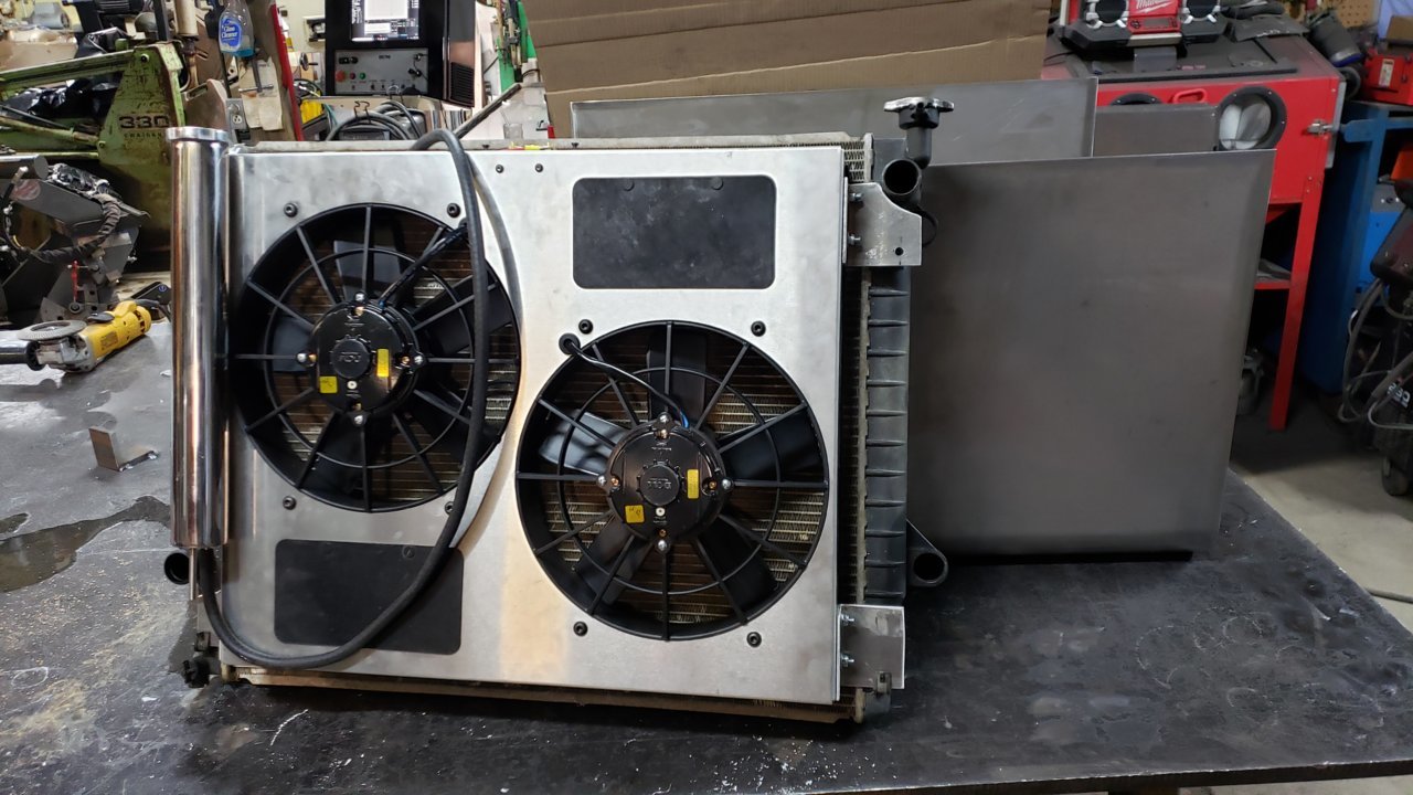

    Fitment is done. Had to make some custom L brackets and I need a longer 1/4" tube for the resi. Overall looks like a great fit. Pictured is fitment to the stock radiator. 20200122_165633.jpg

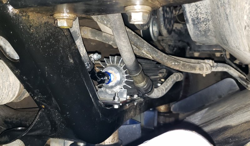

    Looks great! I like that you adapted the lce aluminum reservoir. Wish I had went the derale route now since i have a derale PS single pass heat sink but didn't think to check their catalog. They make some fairly nice AT trans coolers with fans. Now I'm inspired to bend a shroud for the flexalite.
    That looks like a good idea! I'll be sure to keep that in mind when I assemble. I'm not sure if I want to keep the plastic reservoir or not. Was it easy for you to locate the dayco connector?

    Yes i found it @ my local fisher auto parts.

    How much for the shroud shipped. Sent u a pm

    id buy one. looks fantastic @mightytacoman

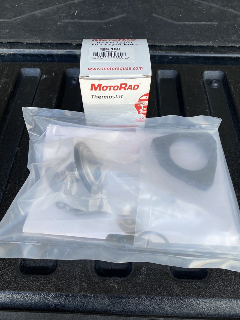

    What was the motorad thermostat part number for the 160* version? Someone help ASAP please!

    This is from @JustDSM.
  11. Jan 22, 2020 at 6:44 PM
    12TRDTacoma
    12TRDTacoma [OP] Powered by Ford, GM, VW, and Mercedes
    Aug 20, 2012
    #85133
    16,670
    Rob
    Concordia
    12 TRD Sport DCLB 4x4 Supercharged
    Boosted
    No. The one torspd posted a few days ago.
    EDIT: Found and updated page 1 with the link to the updated part number.

    Did you buy and install it?

    i intend to simply so I don’t have to worry about any adapter leaks.

    Believe it or not it was not available at any local AutoZone in the area, so I was forced to pass and go with a temporary OE thermostat solution just to get me by for a few days.

    I have a brand new URD adapter and brand new Motorad 456-160 sitting in my garage, and I am in Chandler... I know you were looking for the one piece but there are many many URD adapters in service without leaks I'm sure. Let me know if you wanna pick it up

    As much as I hate giving URD money too... Ive been running the URD adapter and 160 Tstat for a 2-3 years now with no issues.

    I don't like adapters especially when it comes to the cooling or fueling systems and feel much more confident running a piece which is either made to fit the vehicle, or can run with minor modifications to make it fit.
