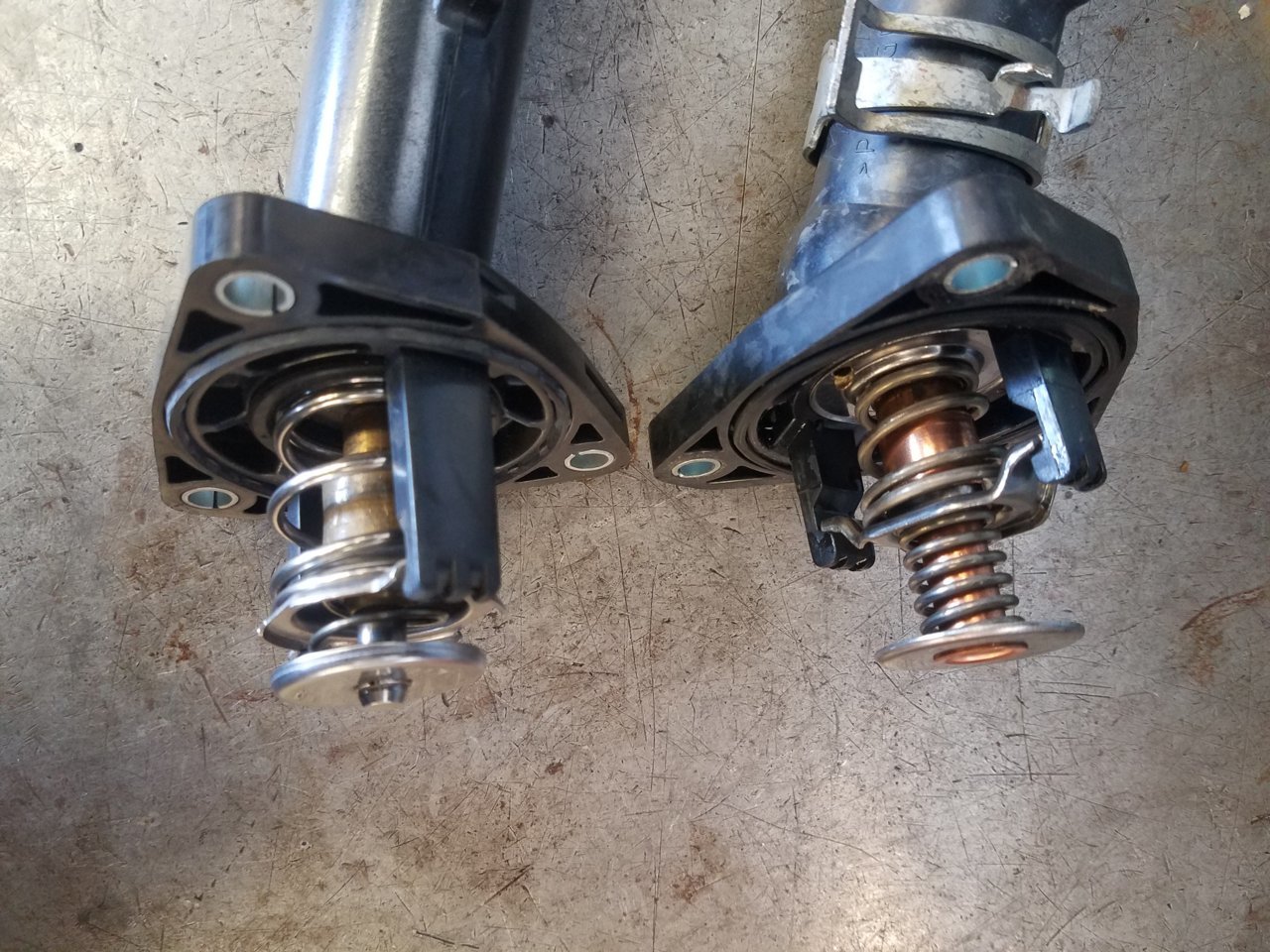

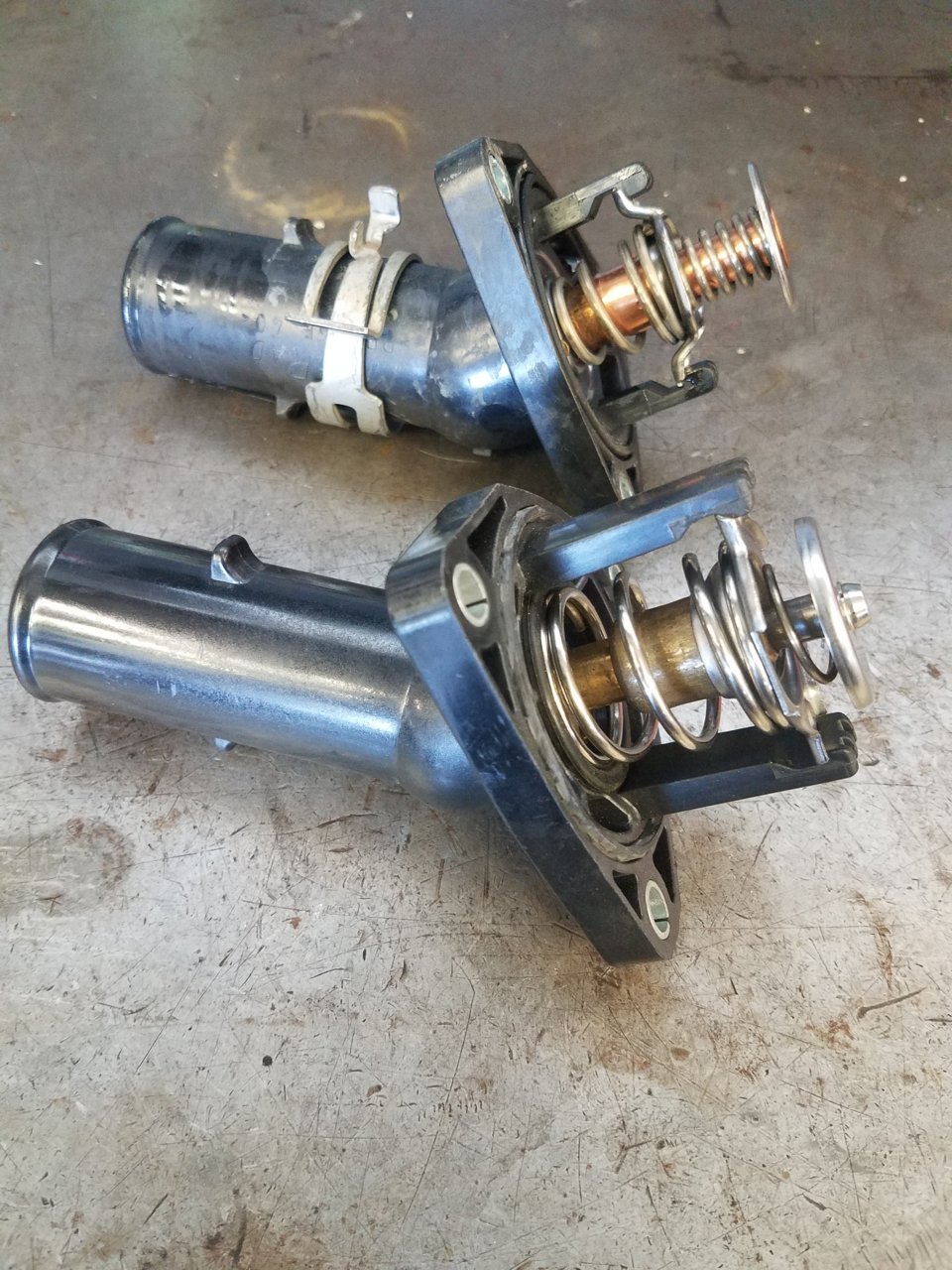

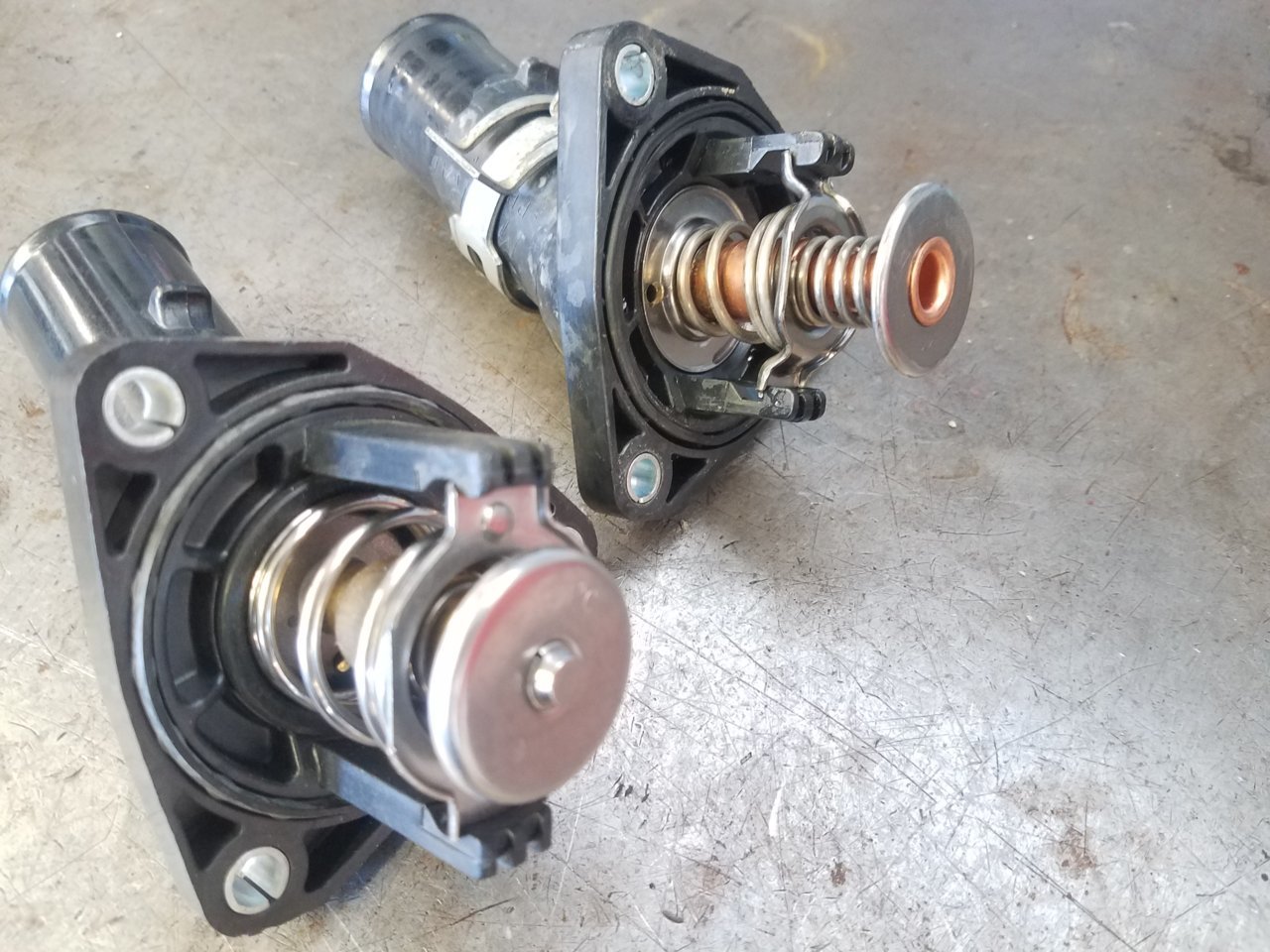

    160 t-stat is officially in and the truck seems much happier overall. While I was doing that I did an oil change because I needed it anyway, general maintenance, tire rotation, air to 32... The truck runs like a champ!
    New temps at idle seem to be about 176, cruising highest temps appear to reach about 181. About 13 degrees cooler than OE. I'll take it. :thumbsup:
    No CEL yet, but it's only been 7 miles since I did the work. More updates to come on if the light turns on or not.
    Here is the comparison from the Mishimoto over the Motorad, the Motorad housing has the radiator clamp over it.

    Mine must then run sooo much cooler due to the larger radiator. Glad you got it in on a stock engine, so we could get some data points.

    how would this impact me in the winter months? crappy heater performance? i got a 170* just so i wasnt on the extreme end of things. open to everyones feedback.

    With my heater running full blast at about 167 degrees at the time, it was really hot and I definitely did not notice an impact in heater performance. It was definitely hot enough to warm my tootsies. :p
