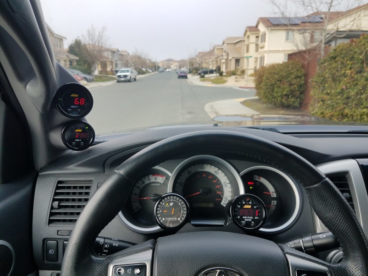

    Here is an old update to some people who wanted to see mounted setup of the Lotek pillar pod. This is the day shot I never got a chance to post.
    Truck was cold started.

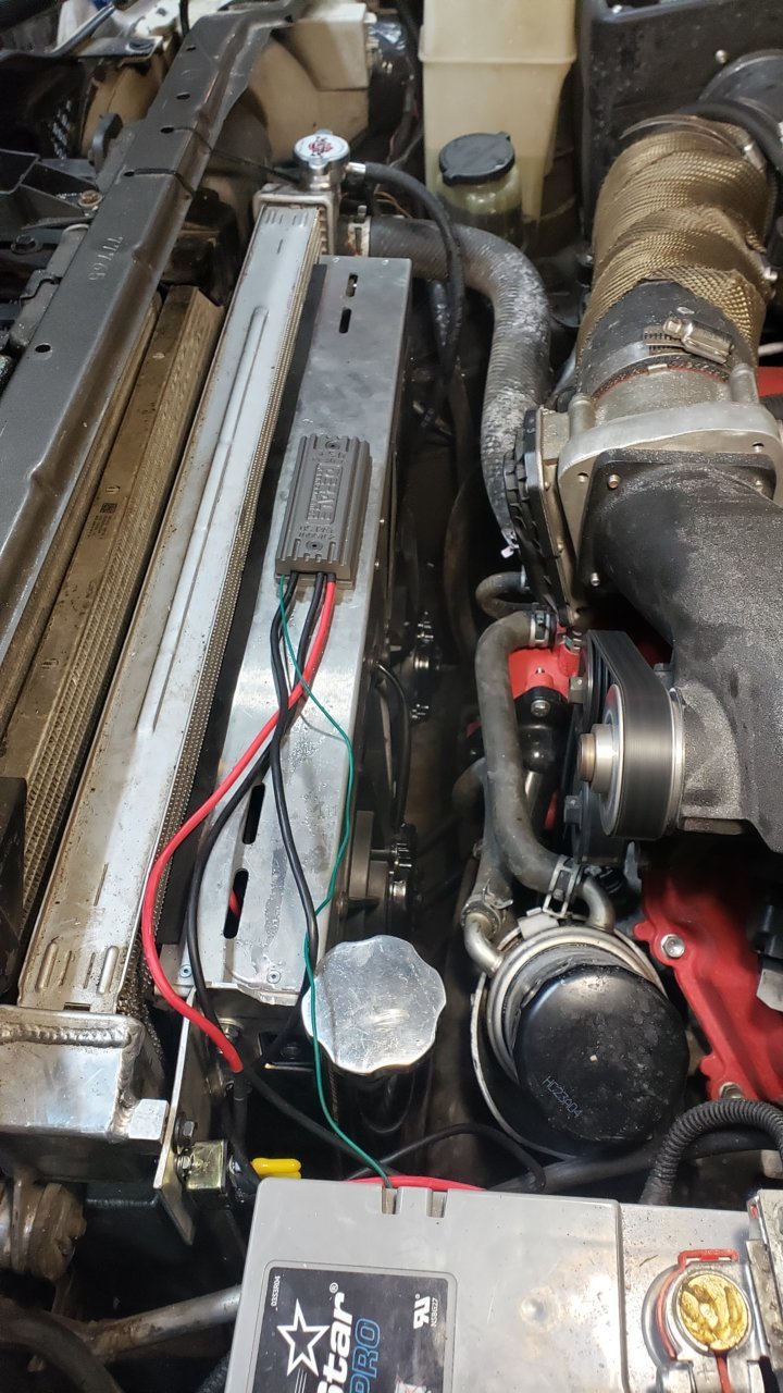

    So much more room for activities! Fan install went smooth. Still got a touch of wiring to do (more on that later)
    160 Mishimoto thermostat installed. I got the fan set to kick on at 185°. Only hit that a few times on the 30 mile test drive so clearly a more efficient thermostat than the 160 Motorad. Average temp was 165-177.
    How to finish the wiring I have an AC override wire that will turn the fans on when AC is activated. Anybody know what wire to tap into in the fuse box for this purpose?

    The color match looks spot on, as well as the fit. Did you have to paint it?

    I didn't actually! It came like this!

    For the a/c wire, you can tap into the “ACID” wire. It’s behind the dash at the A/C amplifier module. Take out the glove box and look straight up.
    Which pin/color to tap into depends on the year of your truck.
    You can also tap into a wire behind the compressor relay, but that one cuts on and off when the compressor cycles. You sort of want the fan to keep going in between compressor cycles to cool the condenser. The “ACID” wire stays triggered anytime the AC button is lit.
