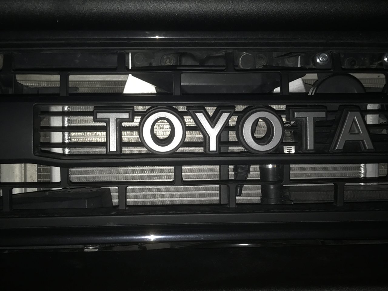

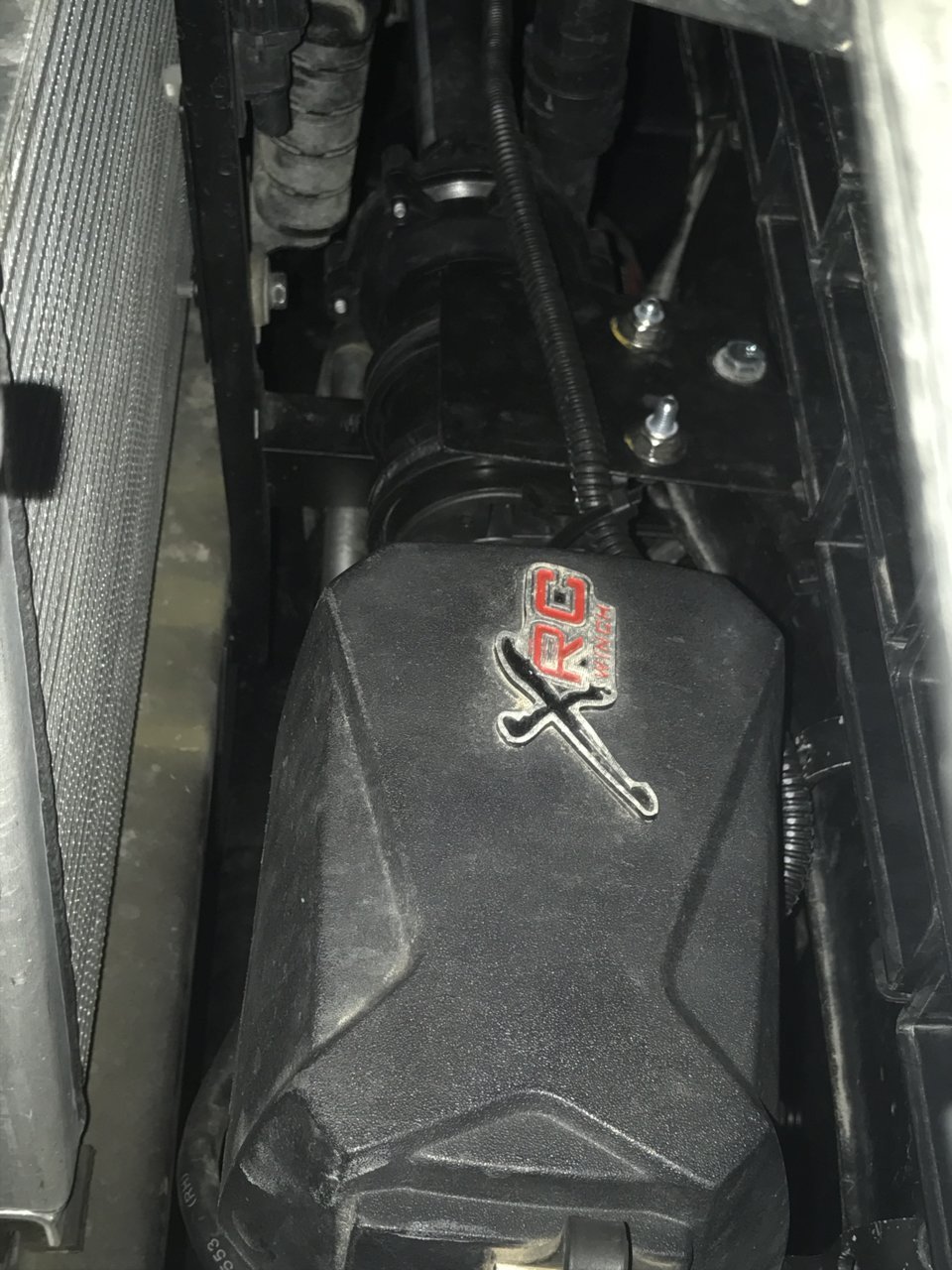

    ha welcome! I saw on recently where they made a bracket that mounted tot he brace of the front bumper to the lift facing out. As long as its low enough you should be good. I need to figure that out as well.

    NEVER Thought to mount it even lower. I have a Warn Zeon and Pelfrey good to know it fits although different winch

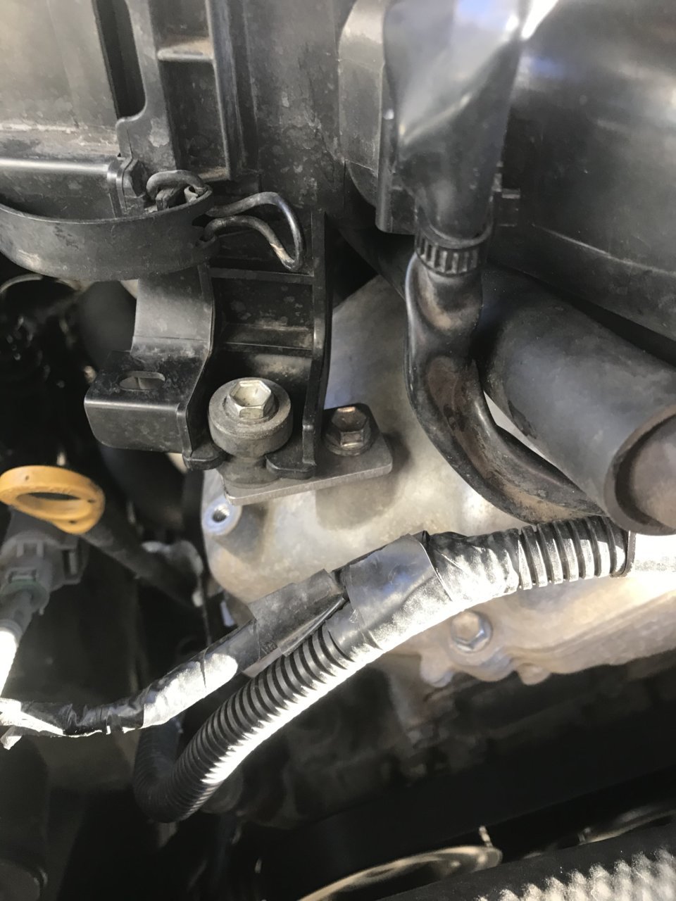

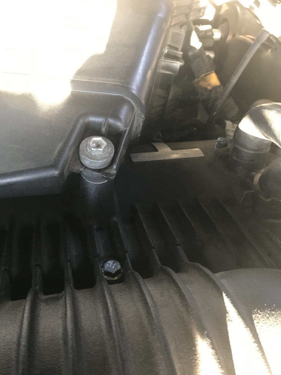

    To all my homies on here. This is a really stupid question and I must had skimmed over that specific part of the instructions when I was doing it, but is there a bracket that helps you adapt one of the factory mounting locations on the air cleaner assembly to the supercharger itself?
    There are two mounting locations to hold the assembly down and the one I am referring to is the one closest to the engine coolant overflow reservoir.

    Not yet, I wanted to see how shifts felt with the 2.7 before deciding on any trans mods. Other goodies will have to wait until my CC stops smoldering. It was a big install weekend so its hard to gauge just the SC install, but 12-15 hours total.
    My pump interfered with the winch initially, so I had to fab up a quick little mount to keep it out of the way, but below the grill line.

    Out of the two bolts, one is rear bay driver side that bolts directly through into the SC body itself. The second one, which Inbelieve you are referring, is front passenger side closest to the overflow tank. There IS a small 1-1.5” flat bar bracket that shifts the mounting location further towards the passenger side. The stock air cleaner bolts onto the bracket and the bracket bolts onto the number 1 bank valve cover. Pictures below reflect both mounting points.

    I feel like I overlooked this fact or it was legitimately never in the instructions... I have the flat bar but I could never figure out where it went or what it was used for. I appreciate it zipp! Thank you!
    On the flat bar part where the blower is moved out to though do you have to thread a new nut on the bottom though?

    Yes, M6 nut goes on the bottom of the bracket. Step 237-243, PG 64-65 in the instructions.
