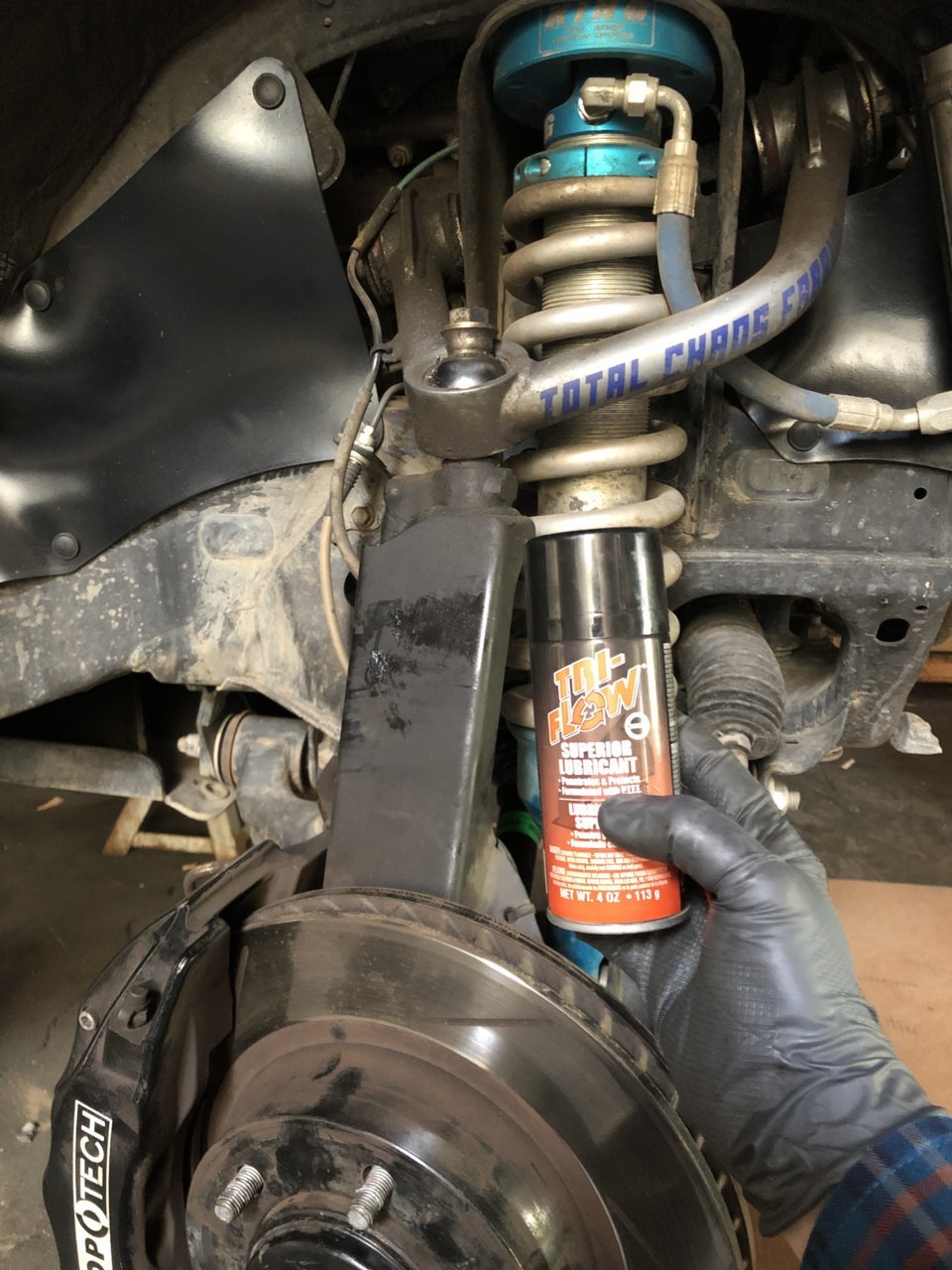

  15. Jan 29, 2020 at 11:05 AM
    Anderson
    Anderson Dudemanbro
    May 21, 2014
    #130329
    3,628
    Anderson
    Benicia, CA
    ProBro
    Stuff
    I’ve had TC uniball Upper Control arms on for over 60k. No strange squeaks. I use Tri flow religiously as a lubricant.
    Photo taken at time of typed response.
    I am actually in the middle of pre trip prep right now.
