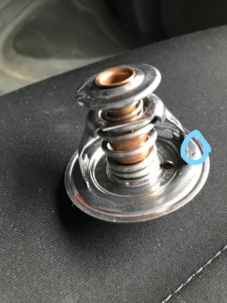

    This may be a dumb question but i just realized i may have botched the t-stat install.
    The post below says that the jiggle valve must be installed upward or within 10* of the center of the top. If i messed up and had this on the bottom, could that cause this issue? I didnt check this during the 170* install or the 180* install but just found it while researching. Gonna pull the t-stat again when i get home to see if that fixes it but now im curious
    https://www.tacomaworld.com/threads...stat-2-gaskets-required.434165/#post-12540354

    Not having the jiggle valve within 20 degrees or between 11 and 1 o'clock roughly can cause vapor lock and induce air into the system for sure.

    You mean like take the tstat out and then reinstall the piping and see what happens? Sorry a little confused here
    What does this little jiggle valve do? I never even realized it had one:anonymous:
    Lol really hoping this turns out to be caused by a stupid mistake i made:p

    The jiggle valve simply creates an opening for any air in the system to bypass the thermostat and maintain complete cooling system fluid immersion on the metal thermostat. A bubble will form in front of the thermostat without it and give a false air reading instead of fluid when not properly aligned.
    You can take the thermostat out altogether and reattach the piping. This will run a wide open system and completely burp any air in the system and confirm the blockage was/is at your thermostat. If the engine runs cool like this then the problem resides at your thermostat. The thermostat or stats are probably fine and just need to be oriented properly. If not at the top when installed then they won't bleed air past them.
    Not a Toyota image, but should give you an idea of what to look for. It will be on the outermost ring and should be positioned at the top.

    That makes a lot of sense. Thanks for the info/explanation! Sounds like i may just not be getting all of the air out of the system since i messed up the install. Will keep yall updated on what i find.. fingers crossed
