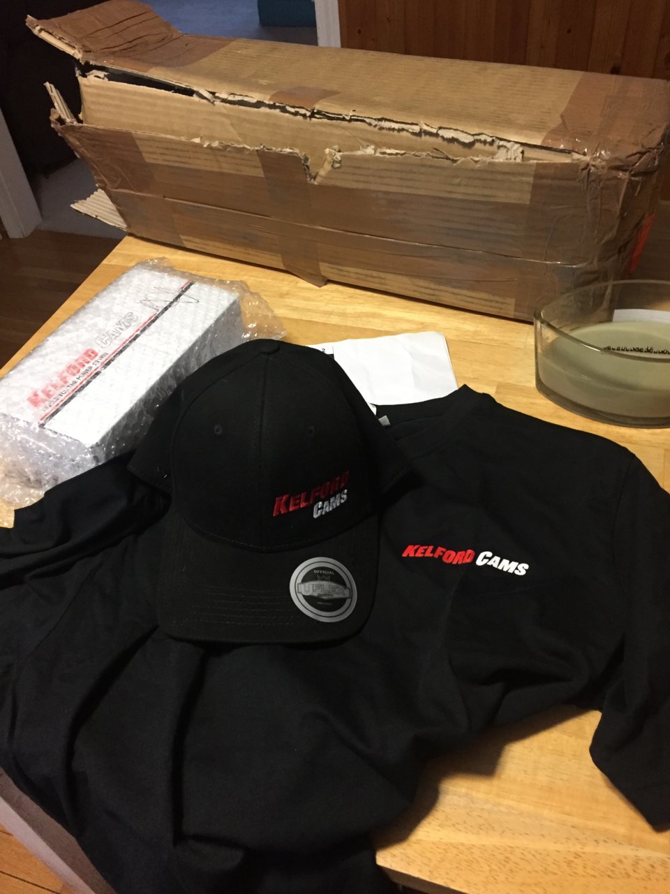

    64A1D941-8993-4BF4-8D39-7526DE7E4EF6.jpg Got stuff in the mail today. Any guesses?

    He messed up and charged me PayPal fee so instead of refunding me the free he threw in a hat and T-shirt. Great quality stuff too.

    Aw man... That's freaking awesome!
    MERCHHHHH!!!!!
