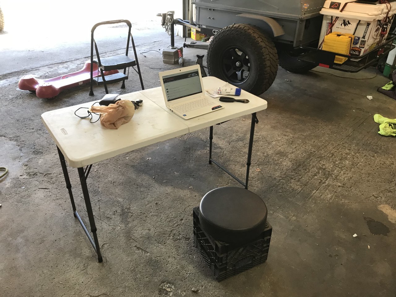

    I figure, I’m getting to the point where I should set up a high-tech tuning station. What do you think? :D

    Customize that awesome trailer and make it a mobile tuning station. Then you can travel the country tuning out trucks.

    HaHa!
    Retirement plan?

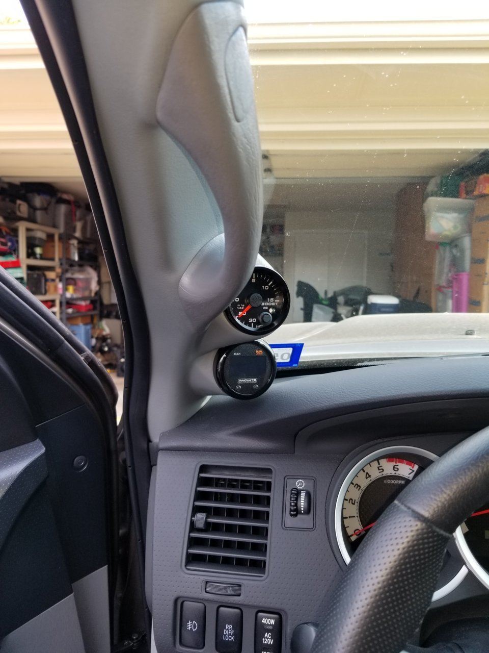

    Mine is horizontal along the firewall and works fine. Speedhut gauge though.
    As others have stated, if your gauge is capable of displaying vacuum then you should be at around 20" of vacuum at idle. Just cruising around light throttle you will never see boost because the bypass valve is open. You can tell when the bypass valve closes as the supercharger gets louder. On mine it's at about 2 to 3" of vacuum.
    If your boost is going up and down with steady throttle then your belt MAY be slipping. You could build a belt wrap mod or I can build one for you for $100 shipped. I'm not sure if it will work with a 2.85 though, it might not have room between the sc pulley and idler.

    Shooter, is your gauge capable of reading vacuum? It's hard to tell from the glare in the pic but it doesn't look like you have any - numbers on the gauge so it may be only a boost gauge, not a boost/vacuum gauge.
    Not the best pic (had it on my phone) but I can take one later if you want.

    Also, thanks @Roostfactor for the boost explanation. I figured it was something like that; fortunately I do not have the sporadic change in PSI, just takes it a second to go from 0.0 and climb (under pressure). My only regret with that gauge is not having the vacuum built into it.

    Nah, no additional pic necessary. I do not have the vacuum on my gauge. Just 0-15 PSI x-series AEM gauge.
