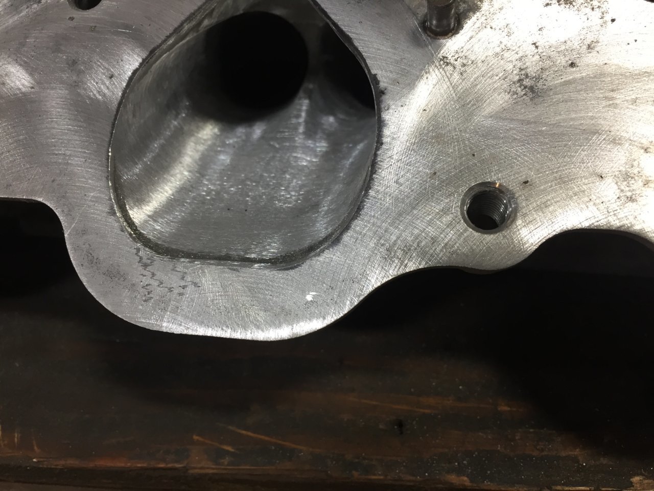

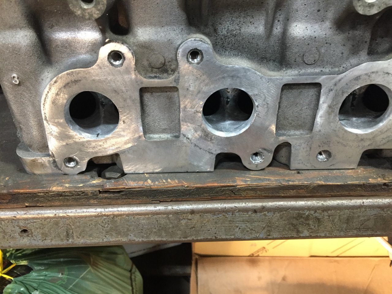

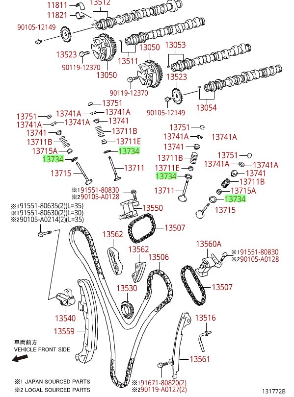

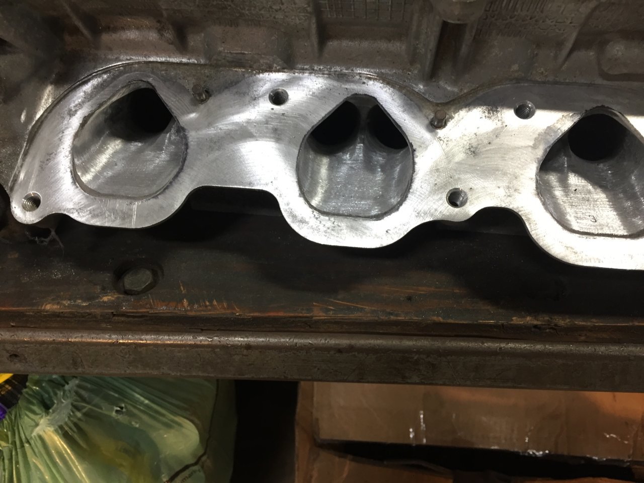

    Getting some head work done today. Very slow at work. Hopefully get this head done and the back together and on next week. @Torspd quick question. The Kelford cams come with the spacers for under the valve springs. Do I leave the factory shim/spacer that’s under the spring? Or remove it
  11. Feb 6, 2020 at 5:07 PM
    o0opackersfano0o
    o0opackersfano0o Well-Known Member
    Oct 18, 2016
    #200102
    2,049
    Tony
    North Berwick, ME
    2005 xrunner swb
    Magnuson supercharger, 2.6 quick change pulley, 76mm throttle body, Doug thorley long tubes, urd y pipe, wot box with 2 step, 170 thermostat, airaid intake, urd short throw, djm 3/4
    A3763620-1B3C-4666-A583-06127AA180A1.jpg DD220CBE-B979-4AFD-AE31-C9B7F15ECB89.jpg 16C825EE-D608-48E0-B90E-E435257440B2.jpg Progress. Ill take more tomorrow.

    I don't have those on mine. Are you referring to between the valve stem and bucket shim?

    My heads may have them. I never disassembled them, after the builder worked with them.

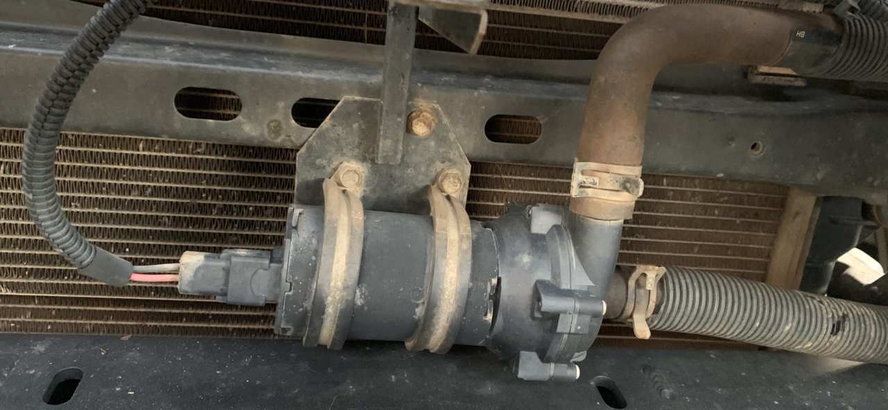

    My bumper is a SOS Offroad stealth bumper. To clear the winch all I had to do was flip those clamps 180 degrees so the pump is above the bolts vs below them. Depending on what bumper and winch you have, it might require moving the more than I had to.

    if moving it requires an odd shaped length of hose ask nice at an auto parts store to see their heater hose selection in back. quite a selection of options.
