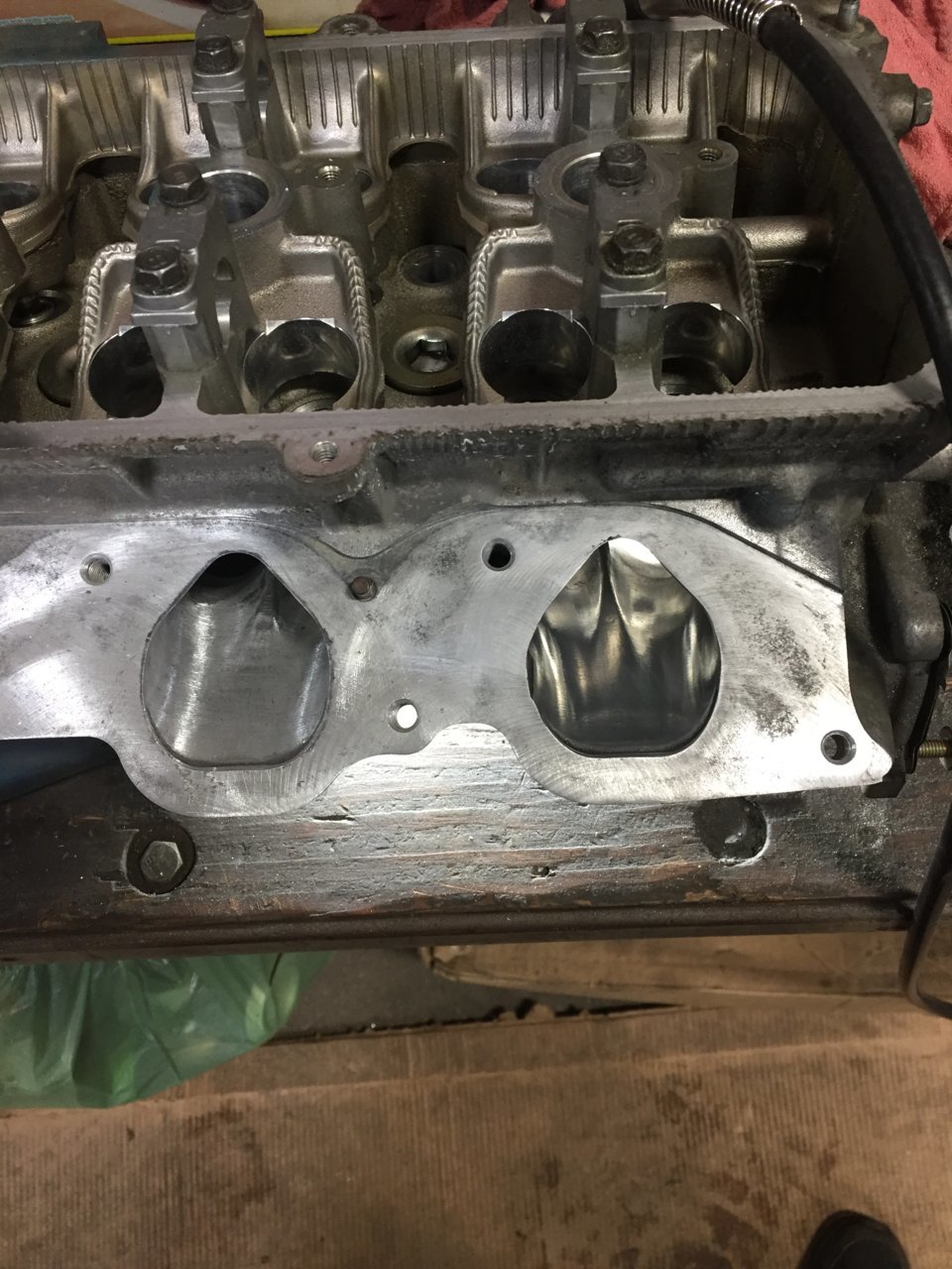

    Finished the intake side of one headA725F319-7275-4150-B961-F5847D9C8C08.jpgB92F01D9-77F9-4CC4-BAF5-5AB77A176025.jpg

    looks perfect. maybe a page 1 diary of goodness.

    One down.

    You do any bench flow testing for some flow data? I know when I did porting in school it was surprisingly easy to flow less air with larger ports by unintentionally introducing turbulence in the port. I certainly wasn’t a pro when I did it, it looked way better, but flowed less as tested by the flow bench.

    I didn’t flow test it. Just trying to smooth out the castings.

    You can build a basic one at home for cheap using a shop vac if it was something you are interested in trying before porting the 2nd head, so you have a before and after numbers. You do want to be sure to setup a test using the same size cylinder bore as the 4.0.
    https://www.musclecardiy.com/cylind...ench-port-flow-testing-cylinder-heads-part-3/
    Of course there is a lot more to the head flow characteristics than peak flow, so it is a bit of an over simplified metric.

    My co worker builds motors and mentioned leaving the intake ports a little rougher for this reason. He had been building since the early honda days and used to street race so he always tried his hand at it. Your comment reminded me of that experience.
