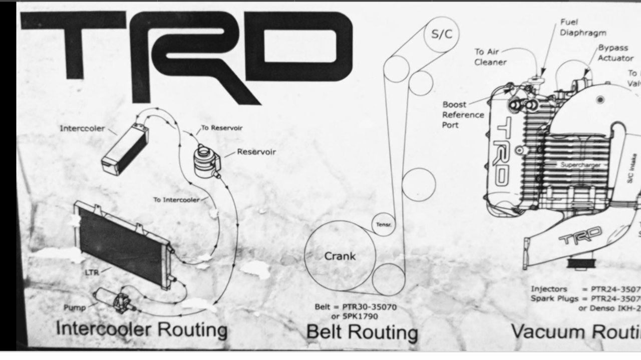

    I disagree. The heat exchanger or LTR is plenty big and always cool. But the intercooler is way too small. And probably the weakest link to this SC.
    So no one is confused what is what

    I think you and I are confusing the terminology for the two. I'm talking about the outer radiator being overbuilt and the inner radiator being the weak link just to clarify that up. :)

    I’m not confused. And I agree with your statement above. But this “inner radiator” is not called a heat exchanger! It’s the intercooler :D

    Heat exchanger: The coolant fluid enters hot through the radiator and leaves cold.
    Intercooler: The coolant fluid enters cold through the radiator and leaves hot.
    And repeats the cycle ;)

    Okay Aftercooler :D

    Technically, they are both heat exchangers, as they both remove heat from their respective areas. LOL!

    Fuck it, I quit. Lol.
    They are both some sort of radiator. One sits inside the blower the other is external in front of the truck.

    Yup in that the intercooler removes heat from the air and the heat exchanger removes heat from the liquid
