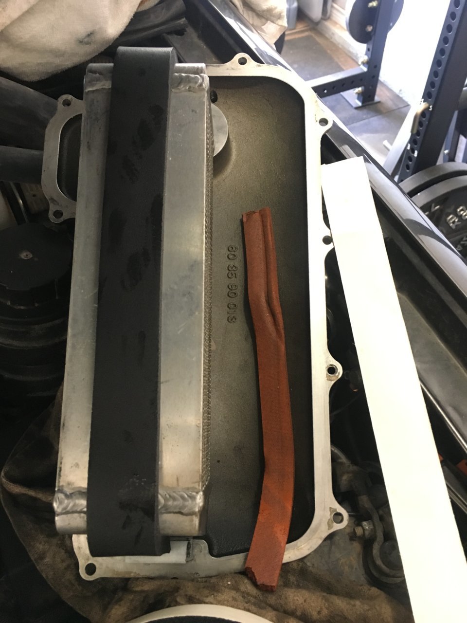

    Y’all think I should try to put something on there for a gasket or roll without it ?

    If you don't have the right material to form a gasket in place of the stock one I would just run it without one for the time being until you can get one. It's not difficult to remove the inner cooler lid anyways so you can honestly just get one and put it on later and the only thing that will happen is you will probably see an increase in boost but your overall temperatures of the blower would likely rise a little more due to the fact that the air is not being entirely cooled from the inside.

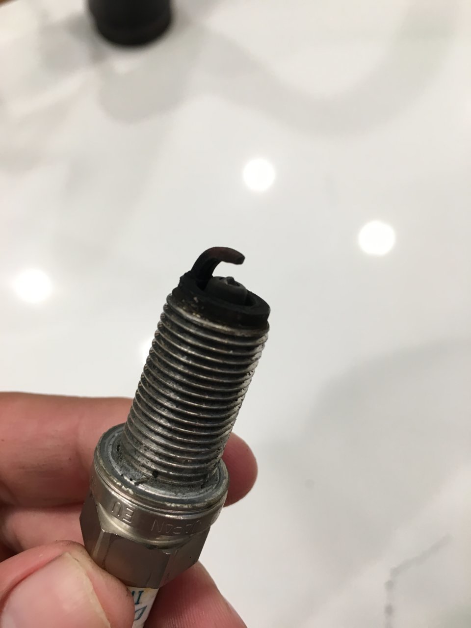

    so when installing the NGK LFR6AIX-11/ 6619, fresh out of the box the gap has to be adjusted ? I just threw some of these on my truck, good thing i havent put the supercharger back on..

    It depends how much boost you are pushing. I'd probably say once you get past 10-11 psi gap becomes a little more critical as tolerances in general need to be more precise and on lower boost pressures the gap can be a little more sloppy, or lenient.
    How would you gap them if so? A standard gapping tool will not fly.

    Ehh... I ran 7-8 psi on NGK and I never regapped and I didn't have detectable spark knock. I'll leave the judgement call up to you, but that is one damn nice gapping tool! I used feeler gauges to figure out what my gap was and went slowly into the gap to determine what mine were set at.
    OE IKH-22 is supposed to be set at .031 from the factory. The reason they go smaller is due to the increase in cylinder pressures that boost creates since spark blowout is a real thing as pressure inside the combustion chamber increases.
    Pull them out and gap them if you can afford it, that's probably what I would do since you have the blower off. I need to update page 1.

    I stopped running copper as soon as I got tuned properly. Copper plugs were simply a perishable item for me due to the fact that I was running pig rich under most part throttle circumstances with the original TRD Tune. Since they are much cheaper than Iridiums I figured it was a no brainier to run them even if they would only last 10-20,000 miles the inconvenience of replacing plugs was offset for the cost of coppers at the time. I have also been running heat range 6/ IKH-22 equivalent plugs for about 85% of the blowers overall life on my truck. I just simply found that IKH-24 is overkill and will cause worst fuel economy as well as more carbon build up in the engine internals for the power levels we are running.
    A more recent log with Justin I ran confirmed that the OE plugs heat range (IKH-22) with our blowers was more than enough to suit the bill even for the power levels I'm at now.
    The issue for me was actually gap, and thinking about it once over it makes sense I had spark knock at .043 that NGKs come in. That's a massive gap for boost, especially 16 PSI. :eek:
