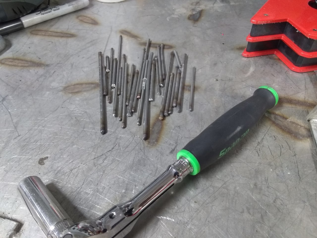

    MIG welder is your friend. Took me a good amount of time to TIG that all on. Good 309 SS rods. The welds will outlast the frame. :D

    I would definitely prefer to burn these in on a lift though. I admire guys that can weld upside down pinched under a truck.

    Thankfully I have had to do much body welding. MIG for certain with that kind of work.

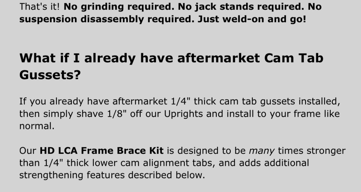

    Don’t have to cut off. Can use the marlin with the TC. Just have to shave an 1/8” off the marlin for it to fit.
