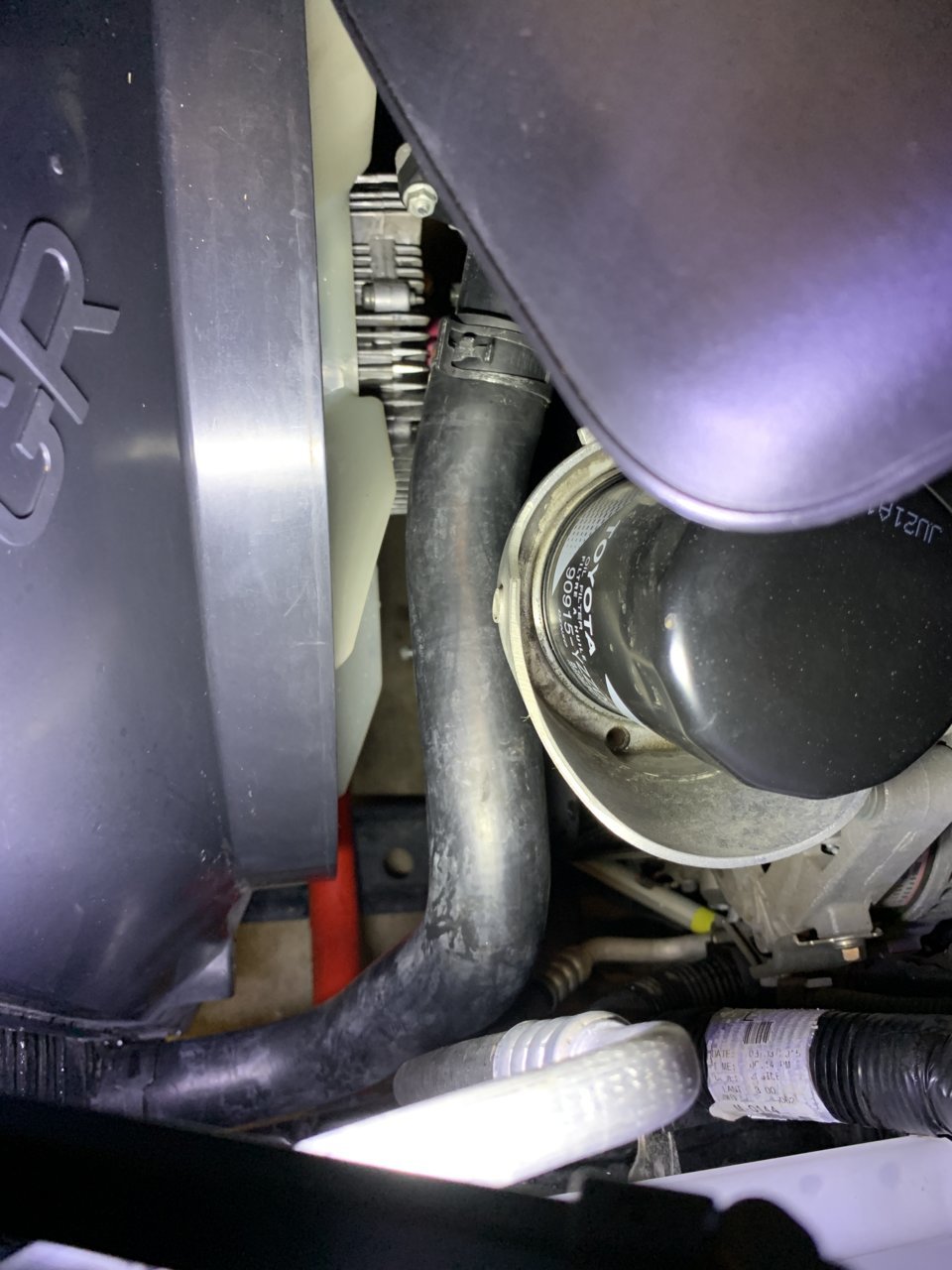

    Just installed the belt drive and thermostat spacers for my supercharger.
    I noticed the hose is pretty close to the fan is this about right for every one?

    Yes it is.

    ^ yup. X2
