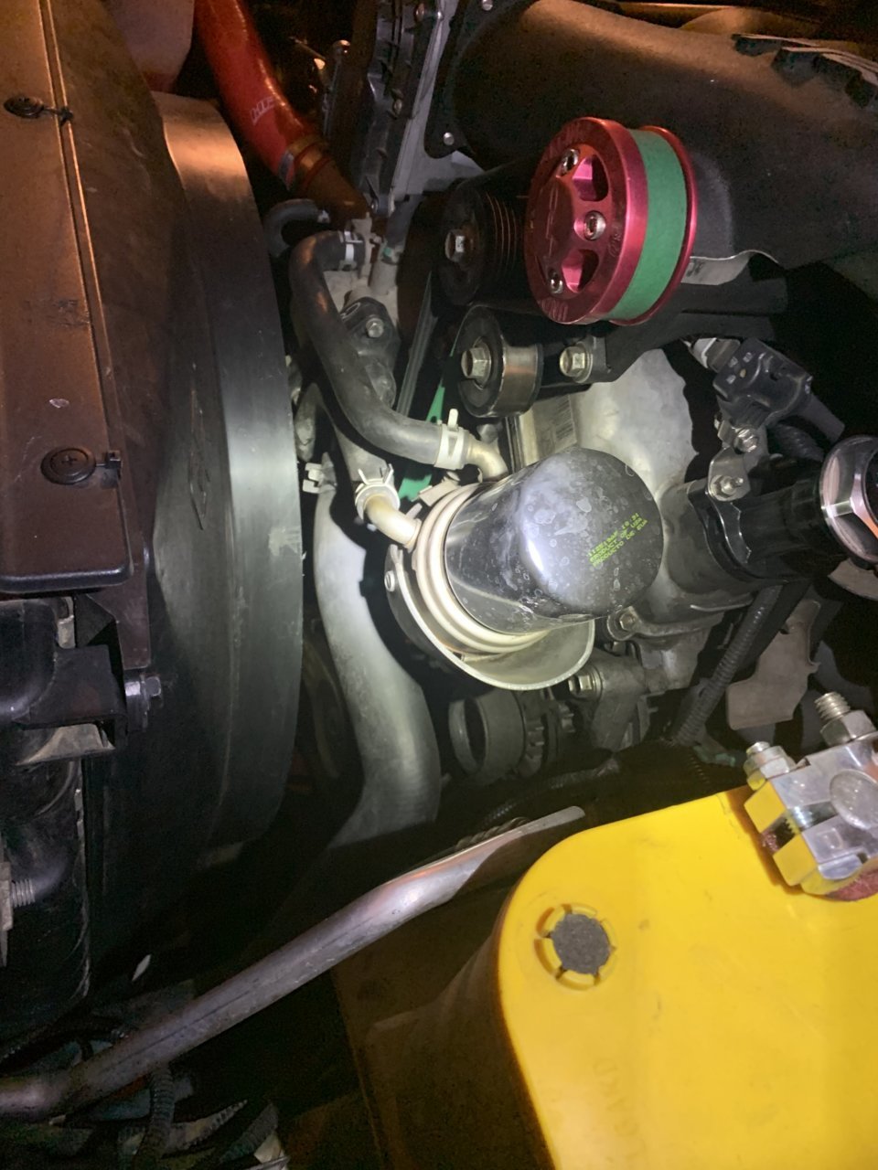

    61

    2011 Tacoma 4x4

    rheath08[QUOTED] and Norton like this.

    nudavinci64

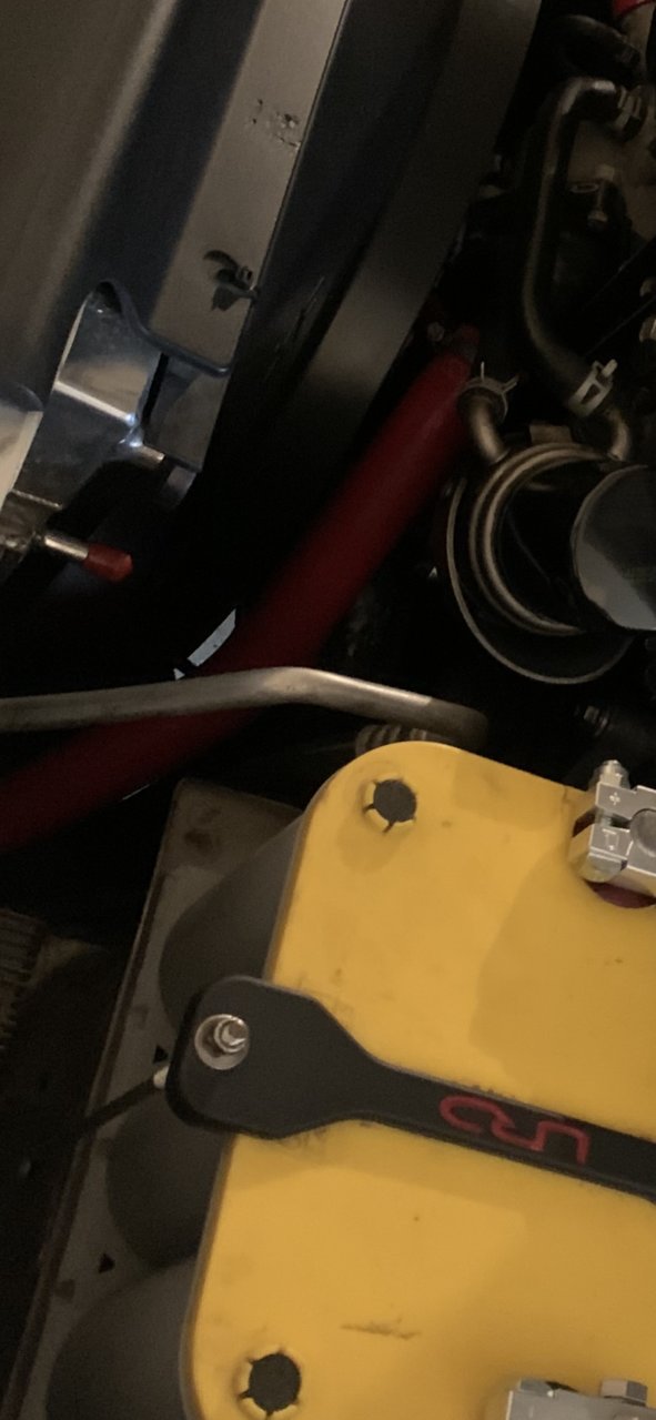

    Get me a better angle. One from where the tensioner is in relation to where the hose is at.
    You know you can post multiple pictures in the same post right? Lol.

    Unfortunately it’s no longer on my truck so I’ll check and see if I have any that will help. I don’t post much but I thought I did put all the pics on one post then I only see one? I’ll figure out what I did wrong for my next multiple pic post haha.

    This one looks a little better

    Ahh, okay, I didn't know you pulled it. The angle of it does look vastly different over OE, then again, as thick as the CSF radiator is I'd imagine things in general shifted over a little bit. We may still be in the need to run a properly made radiator hose for our trucks over attempting to use the lower for the NA version so things sit better in there. I have never had an issue with my tensioner and radiator hose giving me issues.

    Yeah the stock one comes off straight and goes downward after it clears the tensioner. Where the hps starts downward over the tensioner

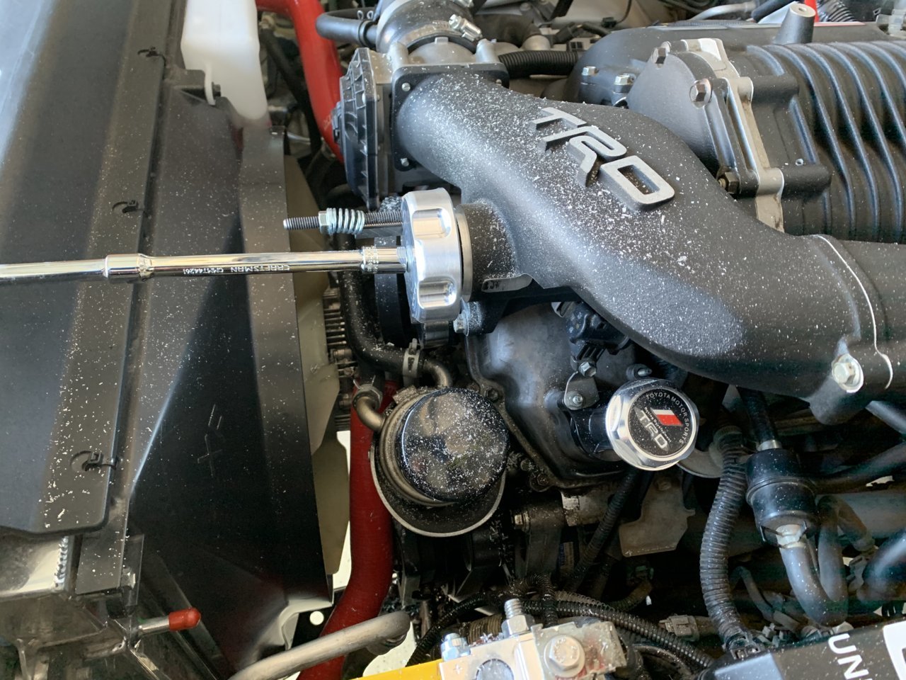

    Finally, some pics for Gerald at HPS to work with. Thanks, @Forumuser . I the lower radiator hose dropped off at HPS to get one redesigned. Hopefully I hear from Gerald soon.
