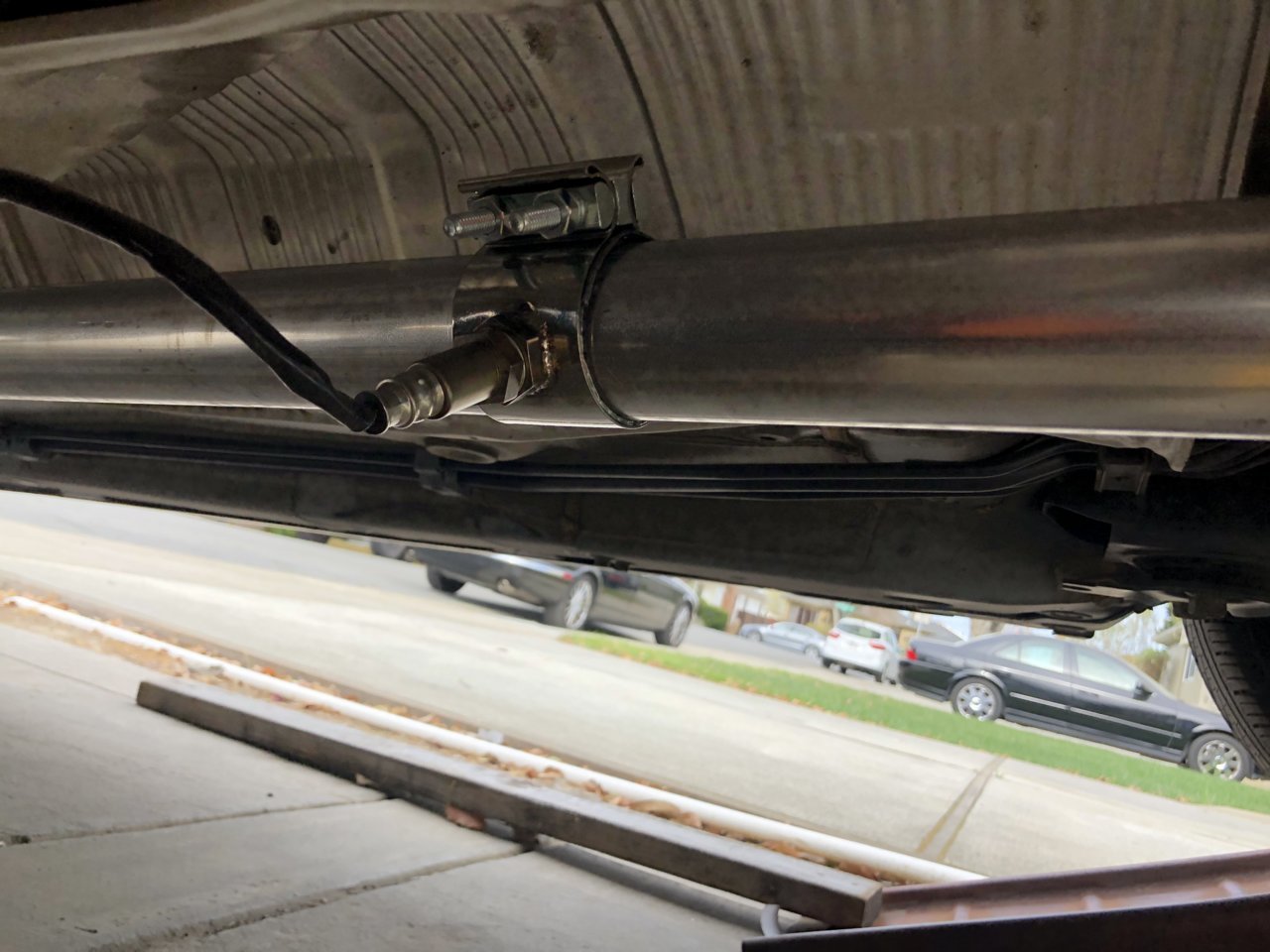

    So I got the 02 sim and it seemed to be okay but still get a fluctuating idleafter it warms up. I need to check the throttle body. Anything else you guys can think of (aside from missing the catalytic converter. Need this POS to run so I can work in the taco.
    Once it warms up it does this. I think it’s code 507.

    cleaned the throttle body. It was dirty but still doing the same with code PO507.
    replaced the air filter while I was in there. I did not clean the MAP sensor.
    going to check the PCV valve next.
