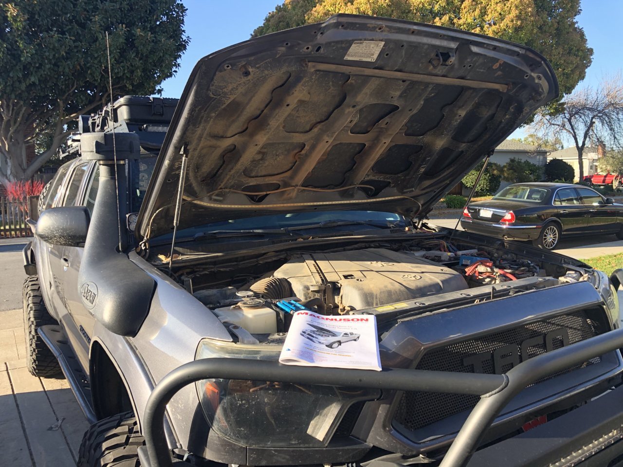

    @nudavinci64 FINALLY!!! ITLL BE AWESOME! Btw, are those long travel LCAs from Total Chaos? How do u like them?

    @nudavinci64 , get a blow gun on that engine before you open it up anymore. Oh yeah, and figure out your plan for the stand alone fuse panel since that location will soon need to be occupied by the reservoir. You could probably just reverse and put it on the passenger side. Enjoy!,

    I aim to please hahah yah I am excited. The S/C along with the box of mods I have piled up will be an undertaking for sure.
    They are the standard race LCAs w/ double bypass. I was knee deep in a mid travel build so I went all in. I prob would have done the +2LT kit if I had known myself better that it would end up this way. Overall though they are built like tanks. A bit less turning radius. Of course they came up with the expedition series a month later which gives you better turning but has not been a big issue.
    Yah I will be doing plenty of cleaning/air before I crack it open. Since I have a ton of wiring and such I did not give it a once over.
    that wiring stuff has been on my mind already and do need to think of what I am going to do. There is a switch pro, fuse panel, solar controller, and a. couple other things over there right now which def uses the space needed for the reservoir.
    I need to pull it out and rewire a few things anyway so gives me a chance to plan it out again. I was thinking of a dual battery setup so I may move all the stuff over to the passenger side. That is going to be a pain but could be worse.ik
    I need to get a game plan once I have the main items together and decide if I am going to go OEM 3.0 or add the quwik change and toss on the 2.8 or 2.5. That will depend how antsy I get and if I can get to some of the more items I am less comfortable with (valve body, fuel rails and fuel pump)

    It may be easier just putting your reservoir on the passenger side. It is just plumbing and not 28 different 18-22 gauge connections.

    With the hose that goes down to the front radiator do you think that would work? I was thinking how I could mount it differently. If I could avoid ripping all that shit out it would save some time. I do plan on re working some of it but def will add more time and don't want to rush it again before tips pile on.

    Hope you got a better CAI to compliment all your go fast parts. That snorkel is basically a restrictor plate and headaches for tuning.

    Not at the moment. limited in options in CA so I guess it all depends what I can get and if it’s more open or still sealed.
    but a new Intake and more open exhaust is def on my list.

    TRD Gen1 intake or Volant with a trd lid from @Coupe. Makes it easier to pass (visual) smog every 2x years.

    thats what i did. passenger side plumbing.
