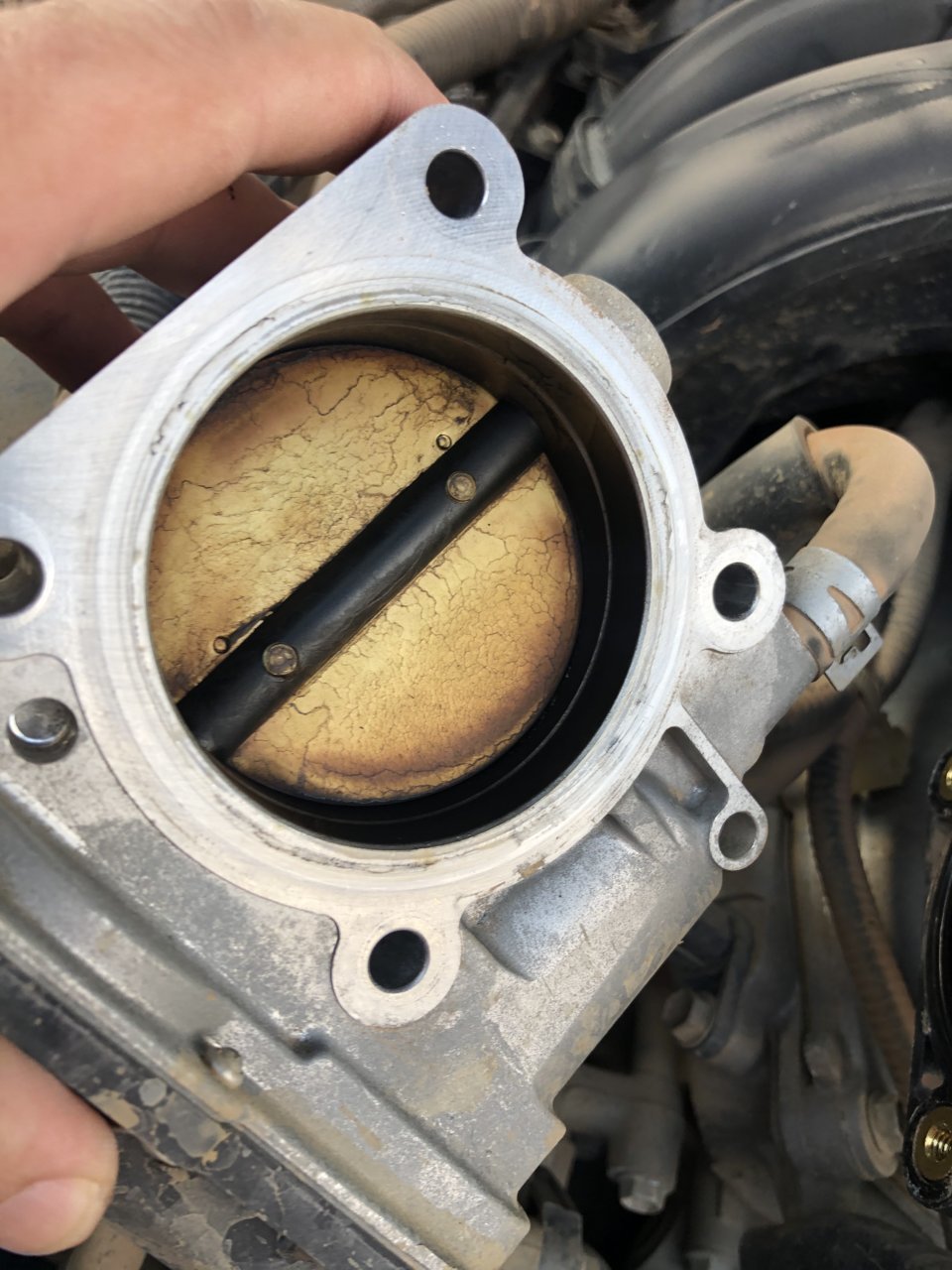

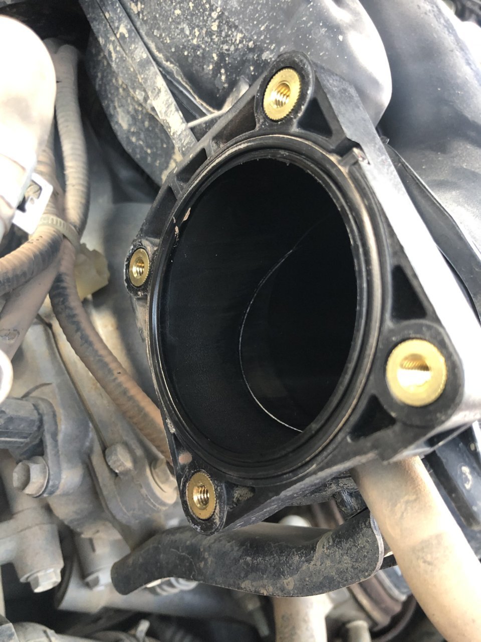

    I bet this wasn’t helping my MPG. One dirty ass Throttle body.
    cant wait to see them sparkplugs

    reason to have a catch can.

    I have one that will be going on with the SC setup.

    Mine looked like that at 63k miles. I def did a good deep cleaning before I slapped it back on.

    catch cans don’t vent lines prior to the TB. It feeds back into the plenum after the TB. However, I still use one. In my mind it does things and helps stuff.
