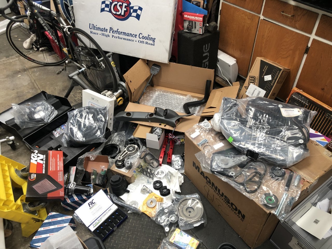

    What do you guys think? Should I do the pulleys/belts first or install the CSF first? next was cam gears but I need to get another valve gasket before I fully complete.
    when replacing with the NST pulleys anything to watch out for in terms of alignment?

    do the pulley stuff first. having a new radiator in the way wouldnt be my first choice.

    i dont know for alignment. take measurements before removing for a reference.

    Would it be better to do cam gears first or doesn’t matter? Since I need another gasket figured I’d continue with the rest

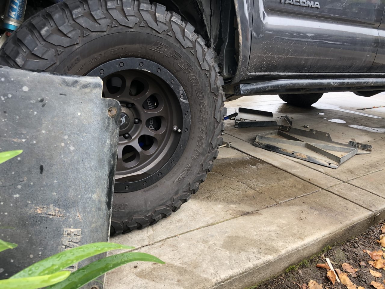

    just spend the last hour taking my BAMF skids off. bullet proof but man they are pain to remove

    The only potential downside to doing everything at once is if there’s any issues it will make troubleshooting more difficult.

    I was thinking about that. I was thinking about leaving stock pulleys on to start but still be doing cam gears. But On the other hand is it’s open why not now. I could forgo the CSF but radiator will already be drained. Which isn’t bad but getting all the armor off is a chore itself.
    Any potential issues I should keep an eye out for?

    thats a hard lesson i learned. do a bunch of mods with little doccumentation. then figure out things. pita!

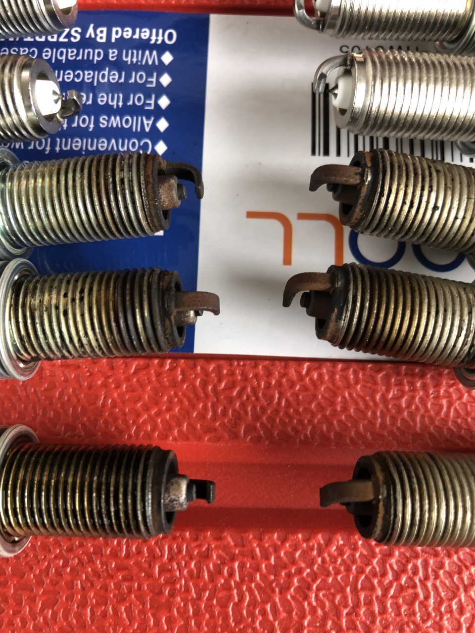

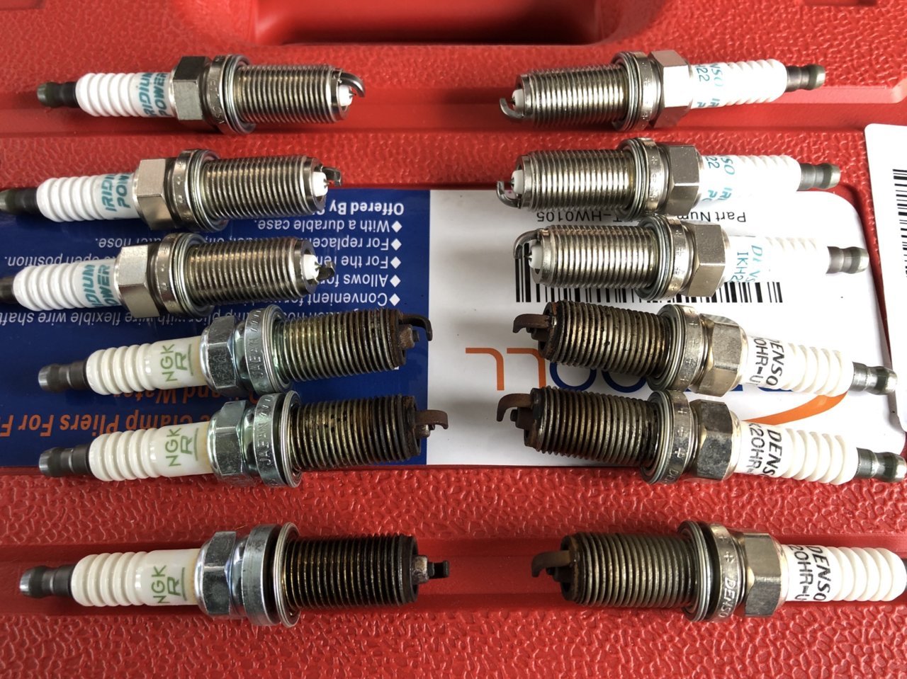

    Sweet Jesus how long did you have those things in for? They look ROASTED! You do know that the OE naturally aspirated plugs are coppers right?

    I kept putting it off since I was going to swap in the new colder SC plugs. Prob 35k miles or all. But yah they are toasted.

    Yah about damn time! had to juggle family today but decent progress this weekend. Skids off, engine/radiator drains and fan removed today. Didn’t get as much done as I wanted to. shooting for firing it up next weekend.

    Oh man.... I am not kidding I have a nearly identical pile of parts. Everything but the FIC's. I need to do what you are doing, Kuddos!
