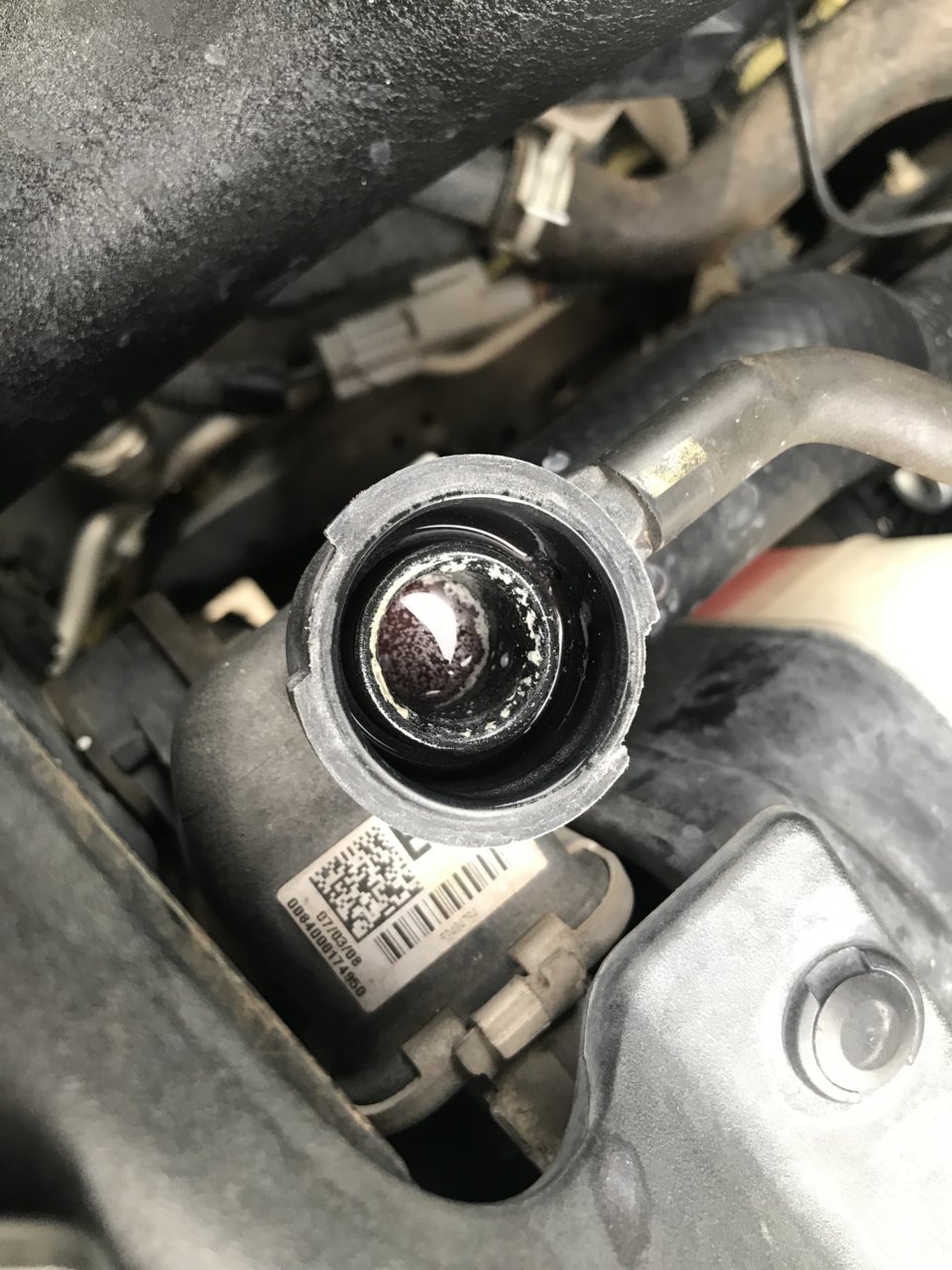

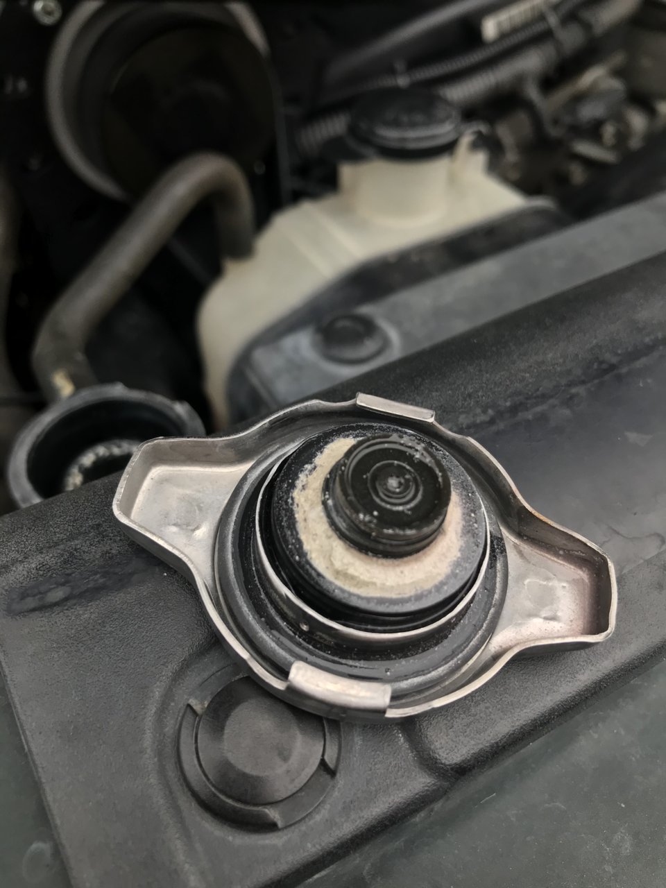

    The bag of sugar you were unknowingly smuggling for me across state lines broke. :devil:

    not that color, and not this truck but yes. i was told its from heat cylces when it is very cold out. thats what i know.

    Looks similar to engine oil getting milky from doing short trips. Might be the same?

    quite possible. short trips without a full warm up for any motor isnt ideal. especially diesels. i know it also rots exhaust systems quick. moisture issue.

    Thanks for chiming in bud! Hasnt been cold here in Tejas lately though..
    My daily commute is 25 miles one way so it definitely gets up to temp regularly. I was thinking this might be head gasket related.. i think mine is on it's way out

    welcome! it had about 115k on it. 4.7 dodge driven very hard.

    Ooo...also a possibility. Hopefully not!

    It looks like it's a blown head gasket, though mild will start to get worse I time.
