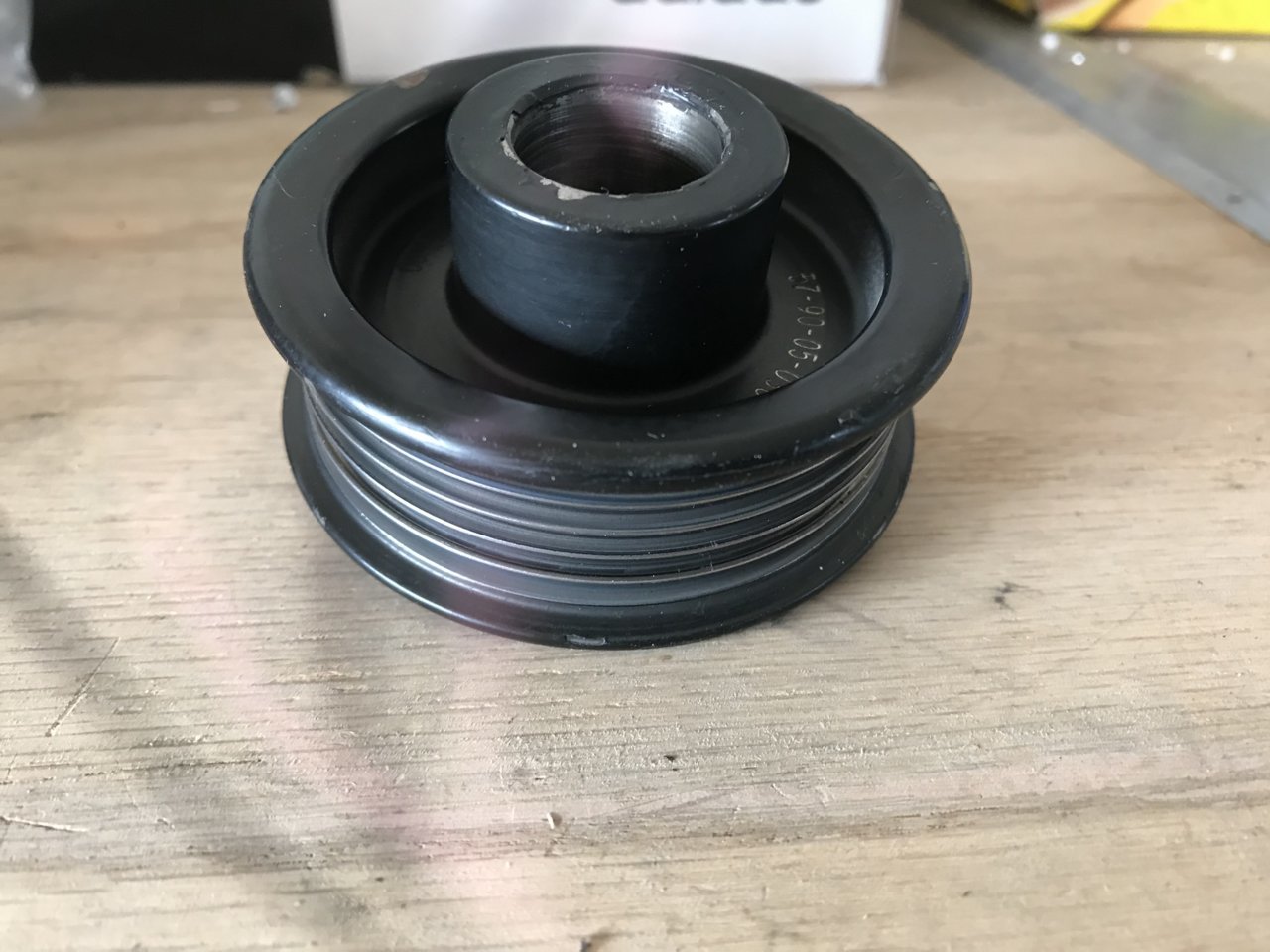

    And that boys is how you take off a press-on pulley and not damage it. I swore I’d never take this 2.55 pulley off after going through the 2.85, 2.7, and 2.6
    Thanks to @12TRDTacoma I’m finally doing a 2.3 :D I’m surprised how light Nate makes his aluminum pulleys. It’s probably 1/4 of the weight of my 2.55

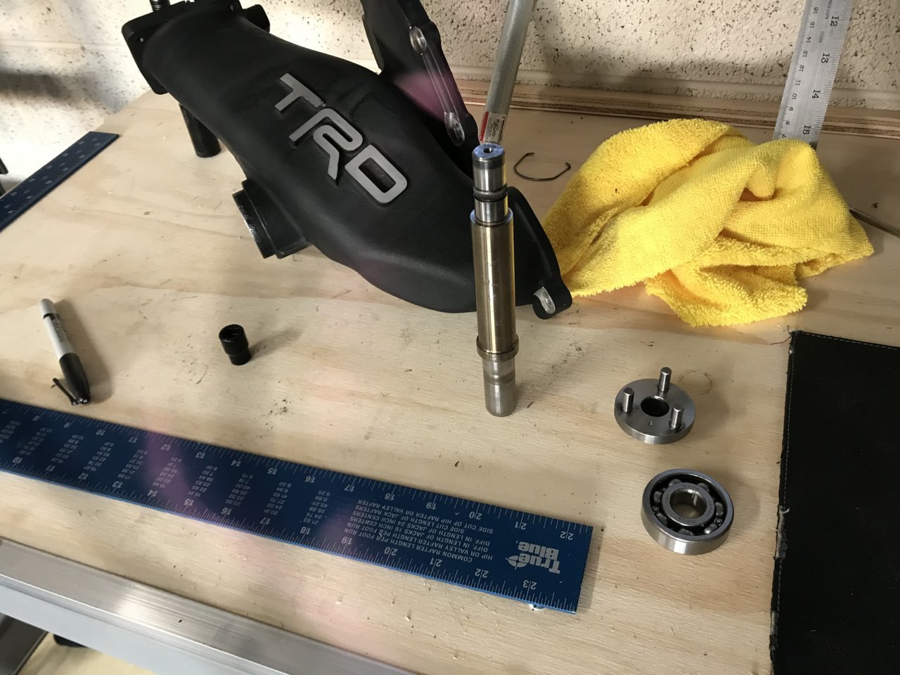

    Well for having a SC pulley ratio equivalent to about a size 2.3 pulley I’m pretty astounded how good the bearings still were. I ran the NST and 2.55 pulley for about 7 years. And 2.6 and NST for a couple years before that. I got about 100k miles on the TRD blower. And rotors look great too!!

    I commend you boys dremeling around the snout with the blower still on the engine for these 2.3 pulleys. Much easier dremeling with the snout off :D

    Just be careful not to bend the hard lines. It is IMPOSSIBLE to get that bullshit manifold back on once you take it off if you bend the lines even just a little bit.
    Attaboy! :thumbsup: the 2.3 is still my favoritest mod out of all these blower mods and the fact that the pulley weighs next to nothing really allows this blower to rev up lightning fast.

    Well since I’m upgrading to a 2.3 with NST kit might as well rebuild the SC in the garage too :thumbsup:
