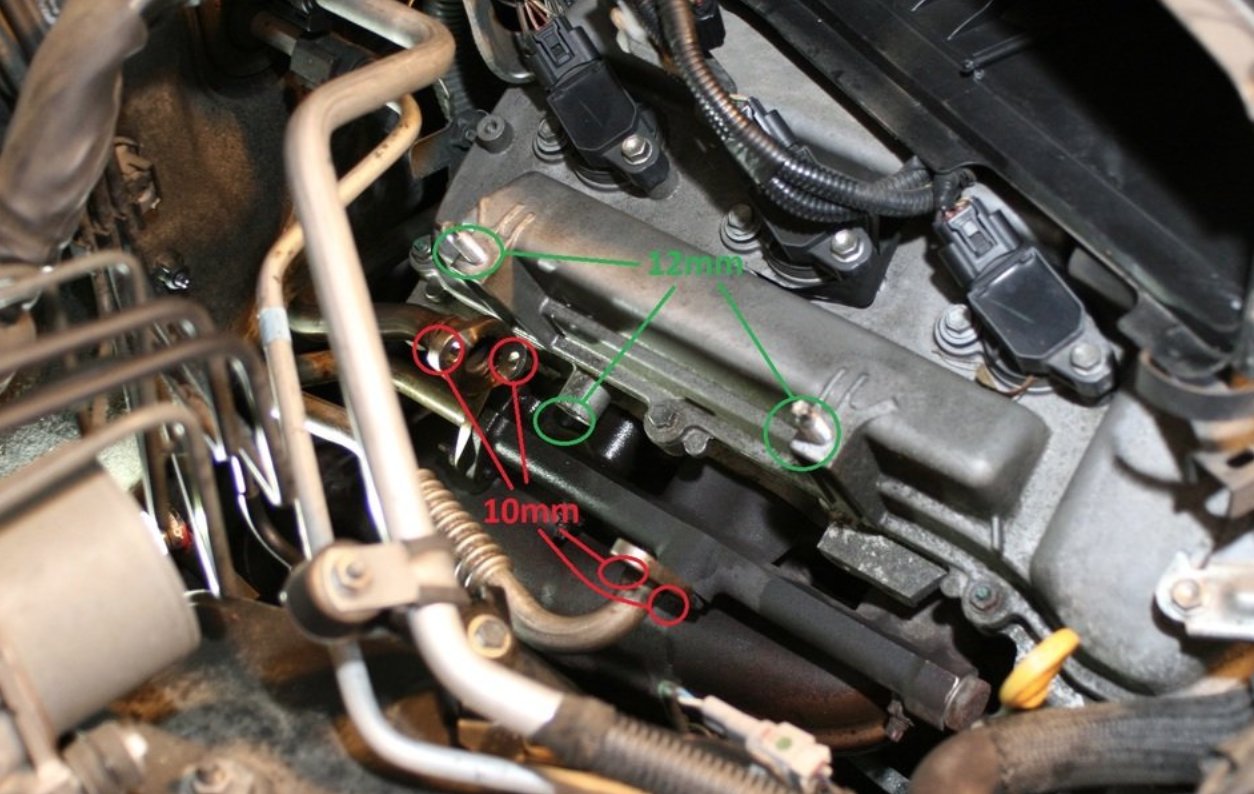

    My toyota Guru's Anyone have an idea what the torque value is for the 2 studs on the secondary air injection noted below? I removed them as it was easier to slide that BS off but since im in CA im tossing it back on.

    just snug it down. it will be alright.

    Thanks that’s what I figured.
