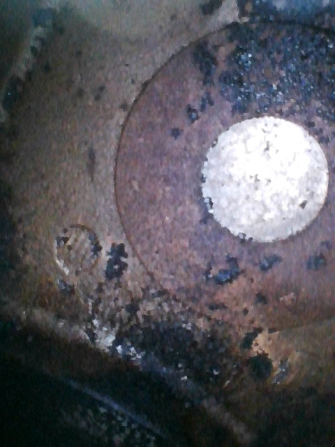

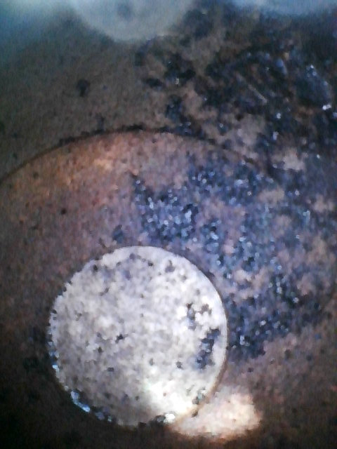

    The top of my cylinders from today’s spark plug change. Pretty clean for 110,xxx miles I would say.
    and my intercooler has very little oil on it, I would say running a catch can works
    Flake Boost and mr.trd like this.

    How often do you change your oil. Also how much oil do you empty from the catch-can each oil change??

    Every 5k. As far as the catch can; hard to say-I don’t wait until each oil change to empty it (although I could). But I empty it every couple gas fillups or so.
