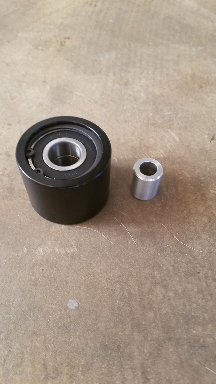

    So I have an upgraded tensioner and the double bearing roller I'm preparing to slap on. The double roller came with an internal sleeve... is that a throw away part? I've looked at page one, and have the proper orientation but the only way this works is without the sleeve...

    TRD Exhaust, URD Short Shift, TRD Supercharger, Hellwig rear sway bar, TWM shift knob, limo tint, URD Y-pipe, URD LT Headers, URD Rear O2 Sim, Custom tube front and rear bumpers, LED spot pods, K&N CAI
    20200328_083739.jpg Little sleeve that came with the pulley

    bottom line is clearence and getting the correct length belt. try without the sleeve.

    Nooooo!!! Definitely not a throw away item. You do, HOWEVER, have to cut down the billet sleeve to size. If I remember right you have to take a small piece of it off for it to fit all in there kosher.
    The idea of that sleeve is to take up some free floating space inside the inner race of the secondary bearing that is in there. Without it, it's sort of just free floating in there and we all know that's never a good thing to have under high speed circumstances.
    Install as such. Mark the excess that sticks out with a fine point sharpie or similar, remove it all and then cut the marked area off. Install and re-run as such..
