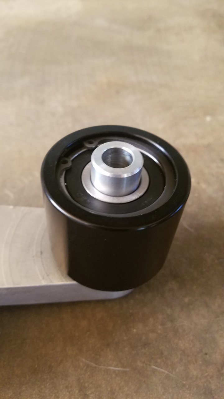

    making sure the pulley is supported properly too. think @12TRDTacoma trimmed the sleeve or something.

    Recognize that tensioner @12TRDTacoma ? Lol and that's what I needed to know! Thank you. Trim it off so its level and supports that second bearing.

    Yes sir I do! I'm still a little sad I had to send it off, but hey the Roush is performing well, so we all win in the end.
    I updated my previous post with some pictures so you can see what I'm talking about.

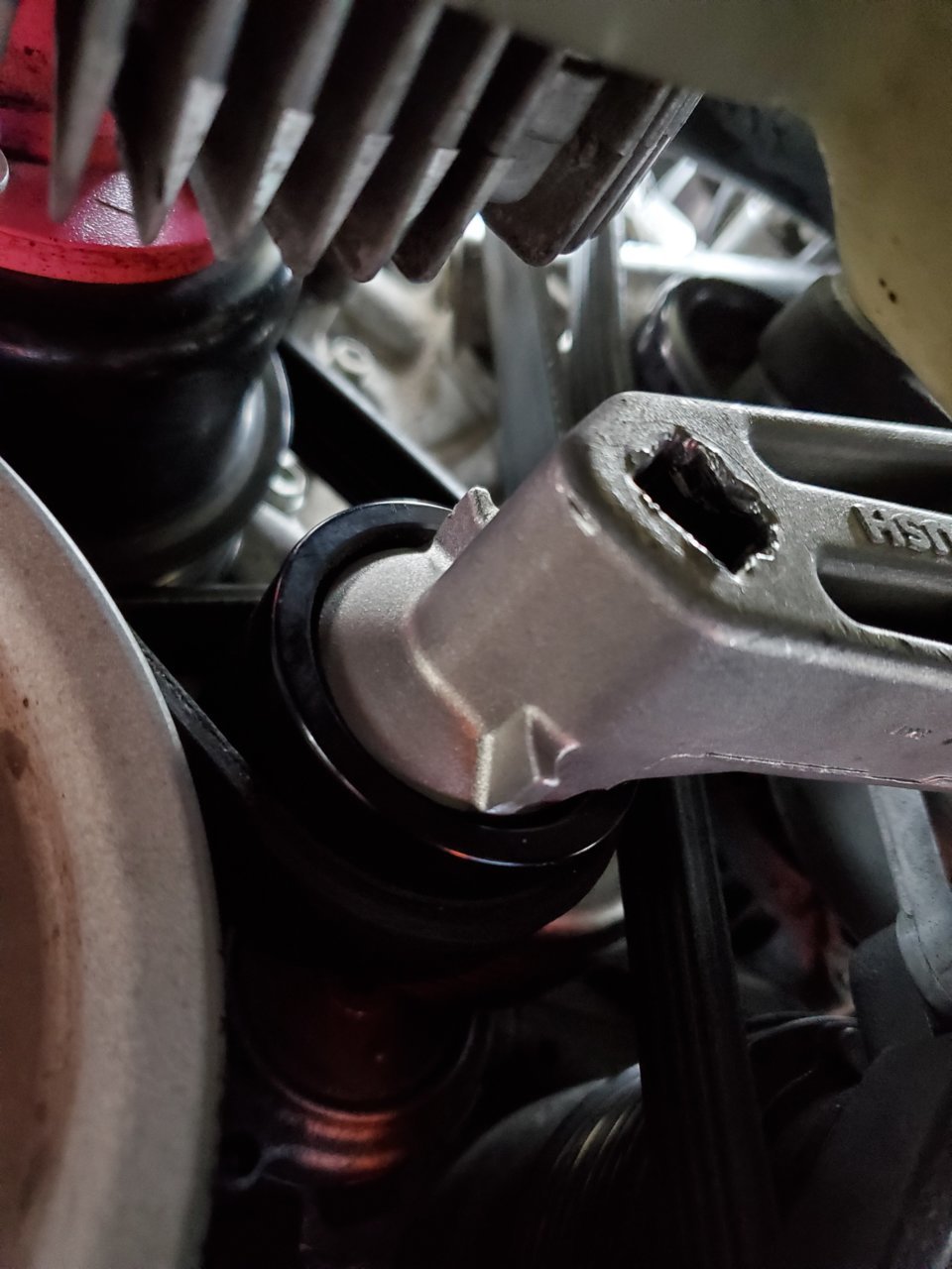

    It looks good man! I tried to clean it up for you the most I can, but it was difficult with the tools I had.

    What did you use to grind it down? wish I had a grinding wheel but either angle or dremel is what’s available.

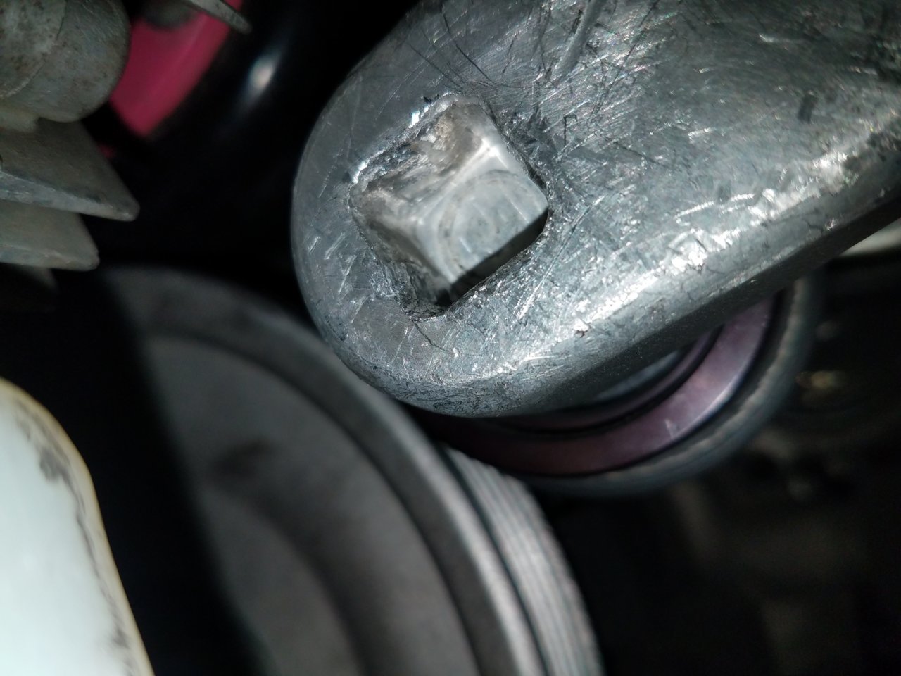

    That's close to where mine is at with the 69" belt which tells me that you did indeed have an issue with a defective belt due to inaccurately measured effective length when it was made. Do NOT throw on any wrap mods because you run the risk of striking the fan clutch otherwise.
    I took this with the old Thump tensioner that @TheFang now has, but that is exactly where my Roush lands as well. Do you see the close proximity of the fins?

    dremel works fine. grinder is just faster.

    I actually used a pipe cutter believe it or not. It took forever but it made the cut precise and then I just sanded down the burs. Dremel or cut off wheel leaves room for error in making a straight cut and I didn't want to risk that.
    If I HAD to use the Dremel I would had finished it off with a belt sander.
    It probably was a faulty belt then for sure.
    Get an RPM belt and modify it man. You won't have to screw with it for a long time.

    Dude, that's genius. I was planning on using an angle grinder with a cut off wheel...

    Just be aware, because you are cutting billet it will take FOREVER because not only is it thick but it is much harder than copper tubing, so go light on the cuts until you really get established in there and use a few drops of oil on the pipe cutting wheel.
