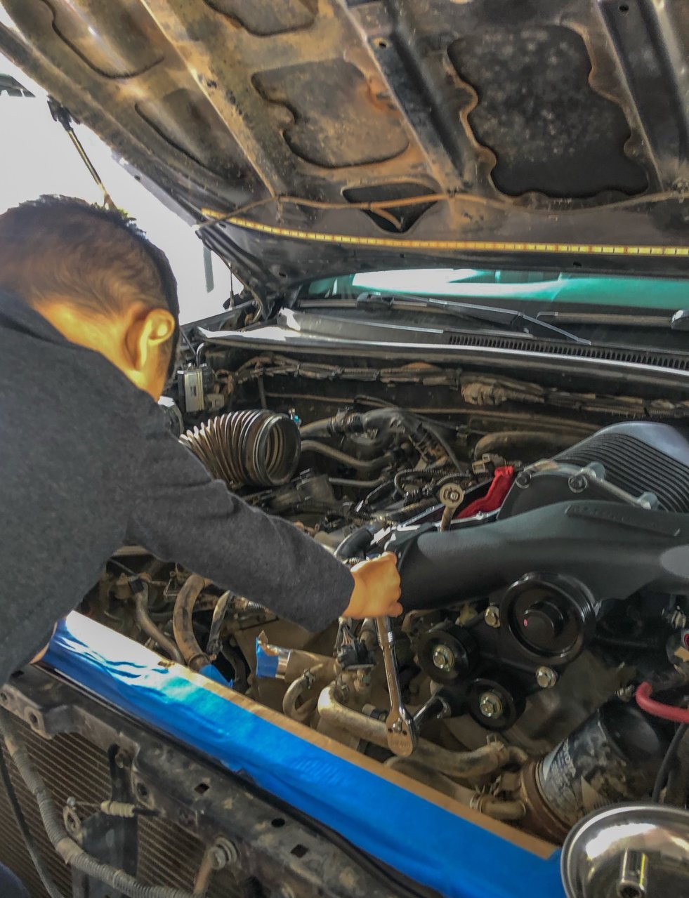

    Jr. let me get a little more done today. Blower is on now to finish up some plumbing. I’m def going to need to figure out the right side of the engine. Absolutely no room over there. Turns out my compressor blocks installing the AFE intake as well.
    Either way, getting close..
