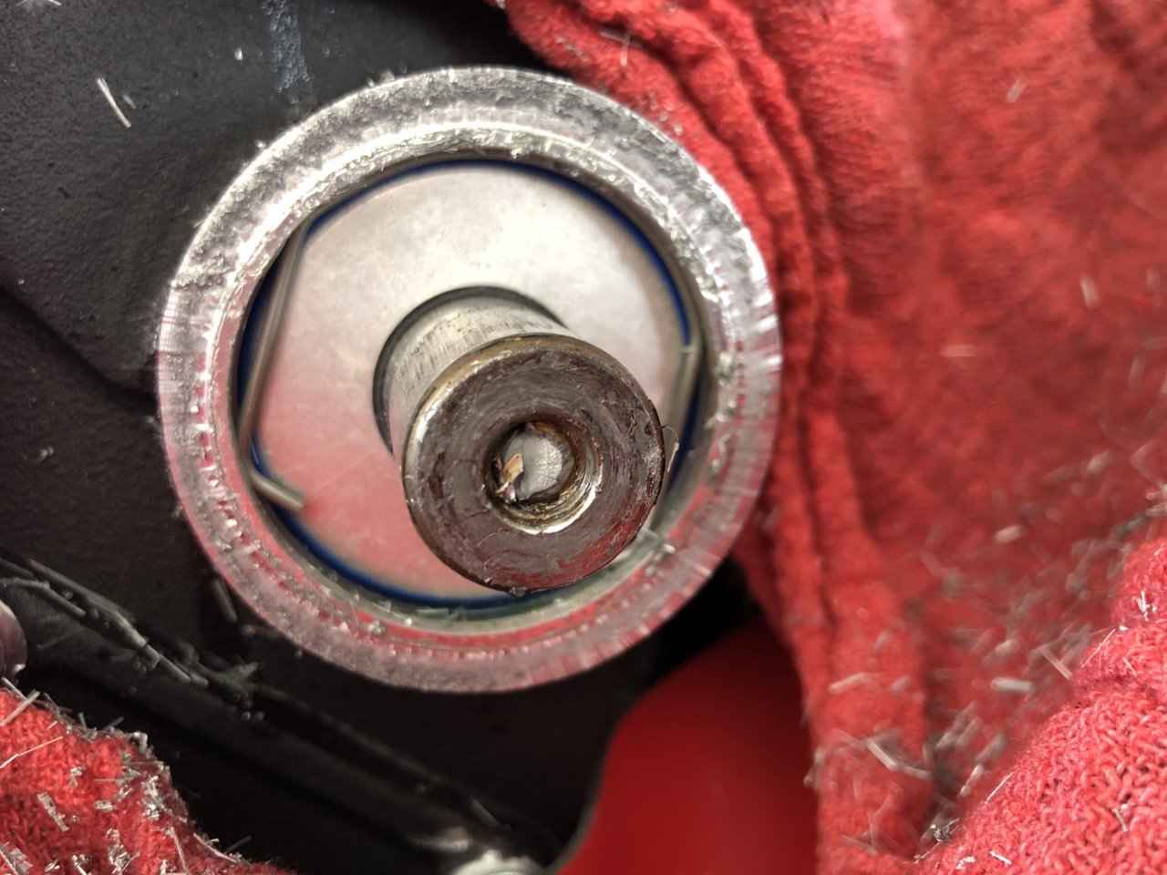

    Started the snout trim yesterday but had to cut short. Using a small impact gun, That work well or doe folks prefer a drill? Figure impact was a stronger option but wanted to get some feedback.

    you may want to trim the s/c snout down to the quick change hup if you ever go smaller than 2.5. tip- when you mount the blower start all the mounting bolts THEN finish off the intake mount bolts. you can thank me later.

    What do you mean? Technically it’s already mounted but not too deep into it.

    Where are you suggesting cutting then? I was going to cut down to the silver part as noted on page 1. Honestly not sure but who knows. I do not even have 1 day on it yet. =)

    for a 2.3 the s/c snout should be even with the hub.

    You have to be messing with me. Damn snout cutter bolt broke in the snout. best option to get this POS out?

    easy out or left handed drill bit.

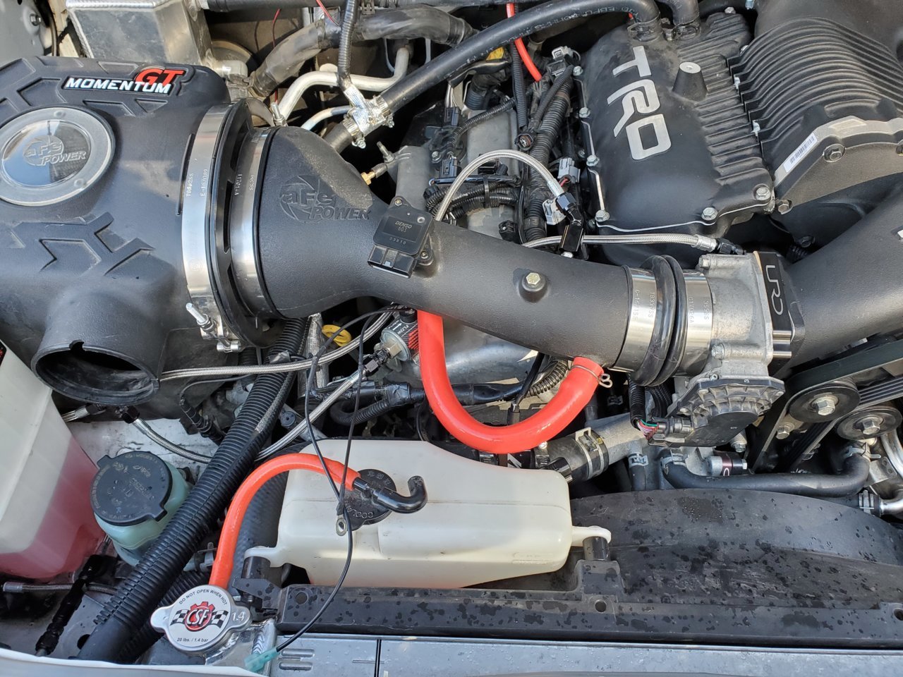

    my 2nd meth nozzle is plumbed. going for wire now to the solenoid.20200330_160914.jpg

    i broke the stud thing on the pulley install tool when i put on my 2.85 stealth pulley way back when and ended up using left handed drill bits

    which naturally I don’t have
