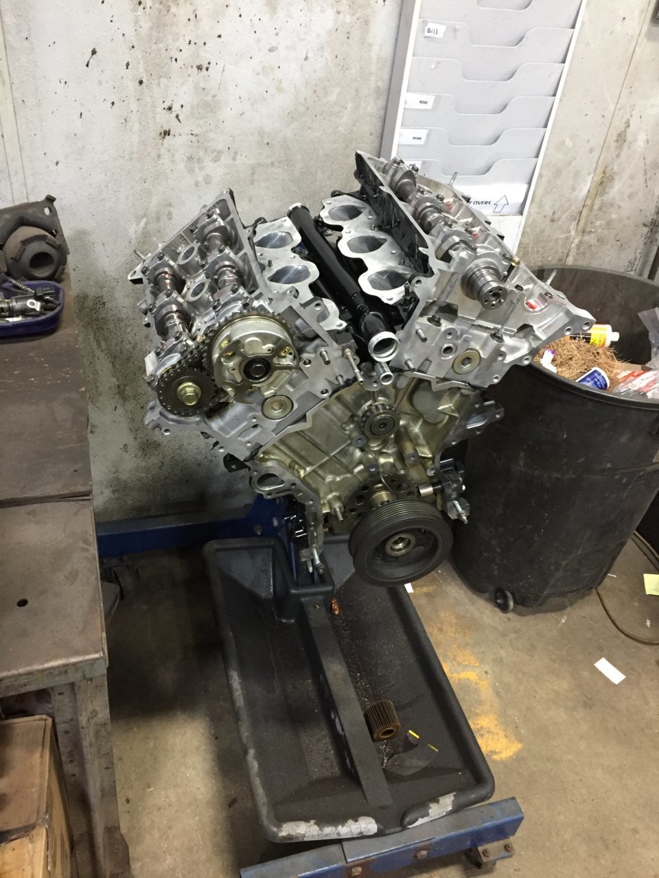

    Need one new lifter. Had machine shop replace install valve guide and match to valve so clearance changed. 3 days out...
