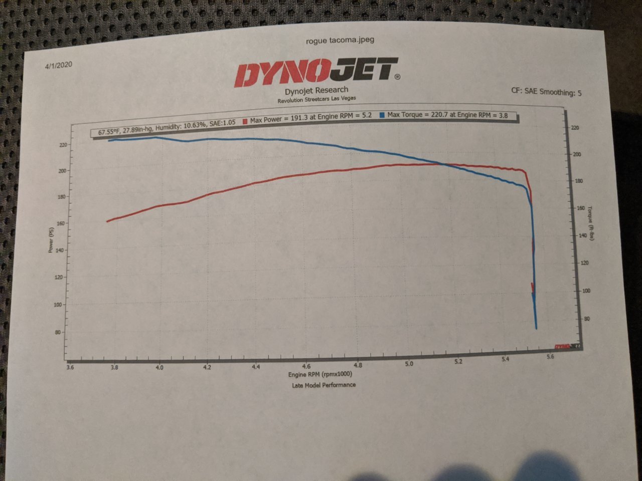

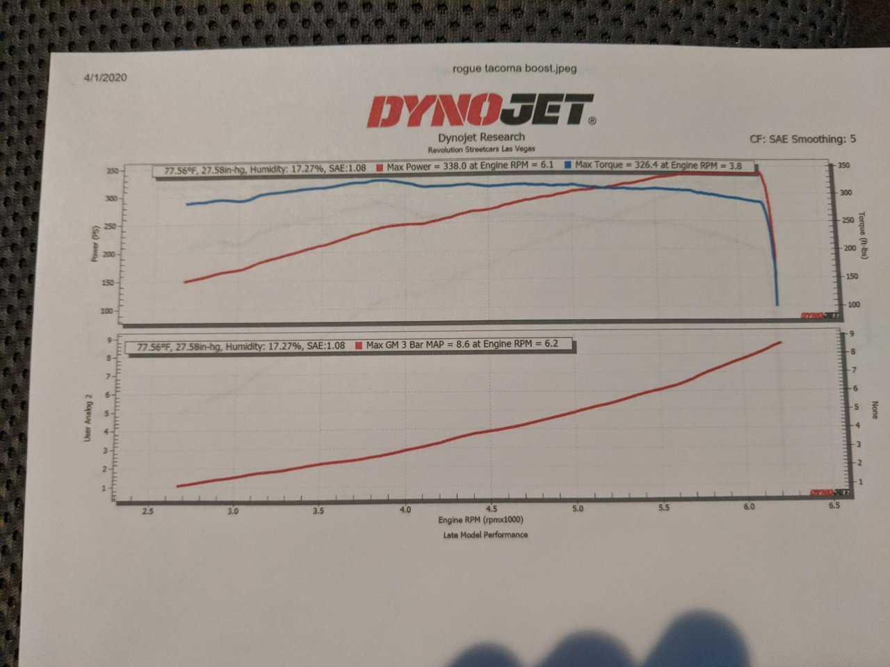

    Just got my truck back!
    Pretty significant gains!
    This is the stage 1 URD mk3 s/c. My truck already had a TRD catback. Time to go gauge shopping!

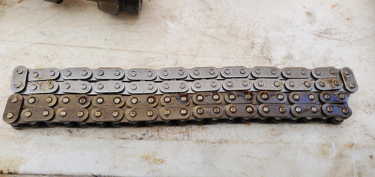

    Good catch.That is very strange. OEM is the new chain?

    Wow.
    Where’s that chain from?

    who would think to check this?!? wow, big fish caught.
