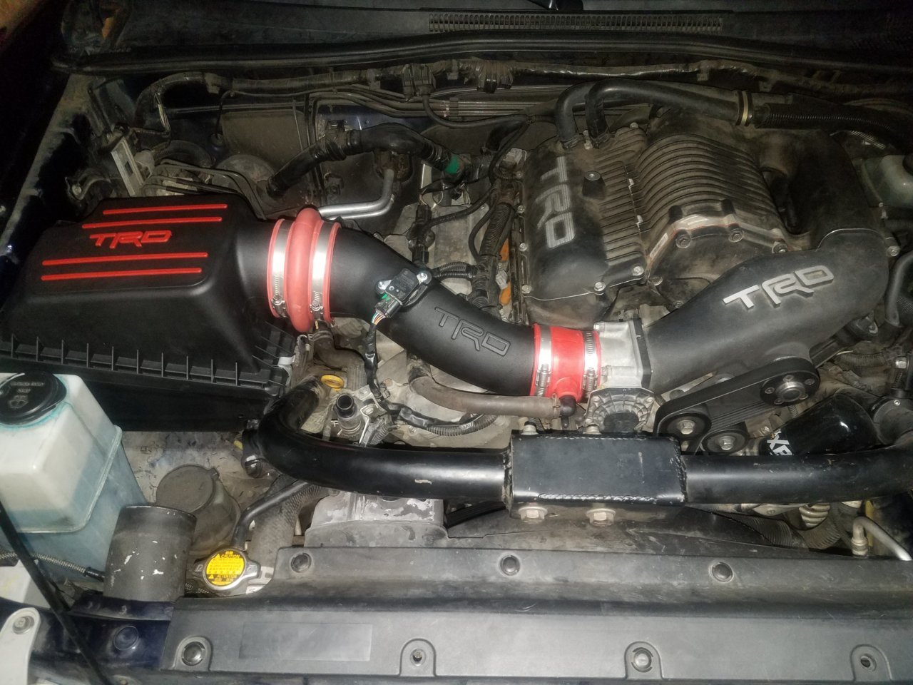

    (Yes I know the SAI isn't hooked up. That's the only remaining thing I have to do) The underhood label is on, and everything else has been done. It still runs the same level of awesome too and it fired up immediately when I tested it before performing my MAF work.

    I'll tell you right now, soldering that pigtail was not fun because of it's it's location and the way the black soft wire protector was not wanting to stay peeled back so the wires would constantly get tucked back into the soft wire protector. Somehow I perservered though and got it done. Thinking about it though I forgot to clip back in a clip and I still need to pull out the rest of my URD intake that is in the front of the truck grille.
    So the project is about 95% done at this point. I should probably steam clean my engine bay soon too just to start fresh. ;)
    I have some air pump relocation brackets made by K&N and I am heavily contemplating using them.. it would put the pump right next to the PS reservoir and I already have them handy. I guess I'll have to take a second look over that in the coming days.

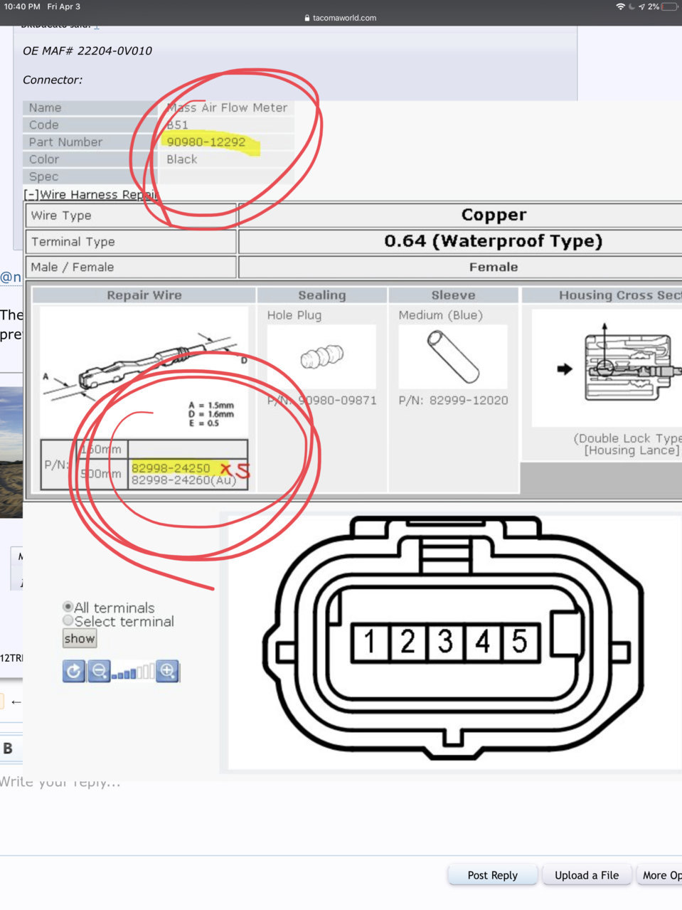

    @nudavinci64
    The PN you are looking for is 90980-12292... That being said I do not know if it already comes prewired. I got my pigtail already set up from the junkyard so my case was a little easier.

    If’n you wanna go the OE route...
    Connector housing is sans wires. You’ll need five of the 82998’s too.
    Probably not the least spendy route. But, correct and readily available.

    yah plus sealing plugs too. thats not too bad but those pins add up. they really get you for those.

    You won’t need sealing plugs. Just the connector and five wires.
