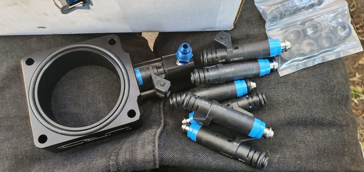

    Which size injectors are you currently using @Flake Boost ? As well as which brand?
  10. Apr 4, 2020 at 10:45 AM
    Flake Boost
    Flake Boost FORCED
    Mar 18, 2020
    #322445
    207
    80lb
    Deka 80LB/800cc x 6
    Deka 640cc x 1

    So how long have you been running this c39-92 rotrex kit? @Flake Boost

    The Ucon is not a standalone tuning device. It’s piggybacking and limited to the stock ECU. If hptuners can’t help on a real time dyno tune then you should go haltech 2500 with a boomslang. Believe me when I say the Ucon is frustrating! :cool:
