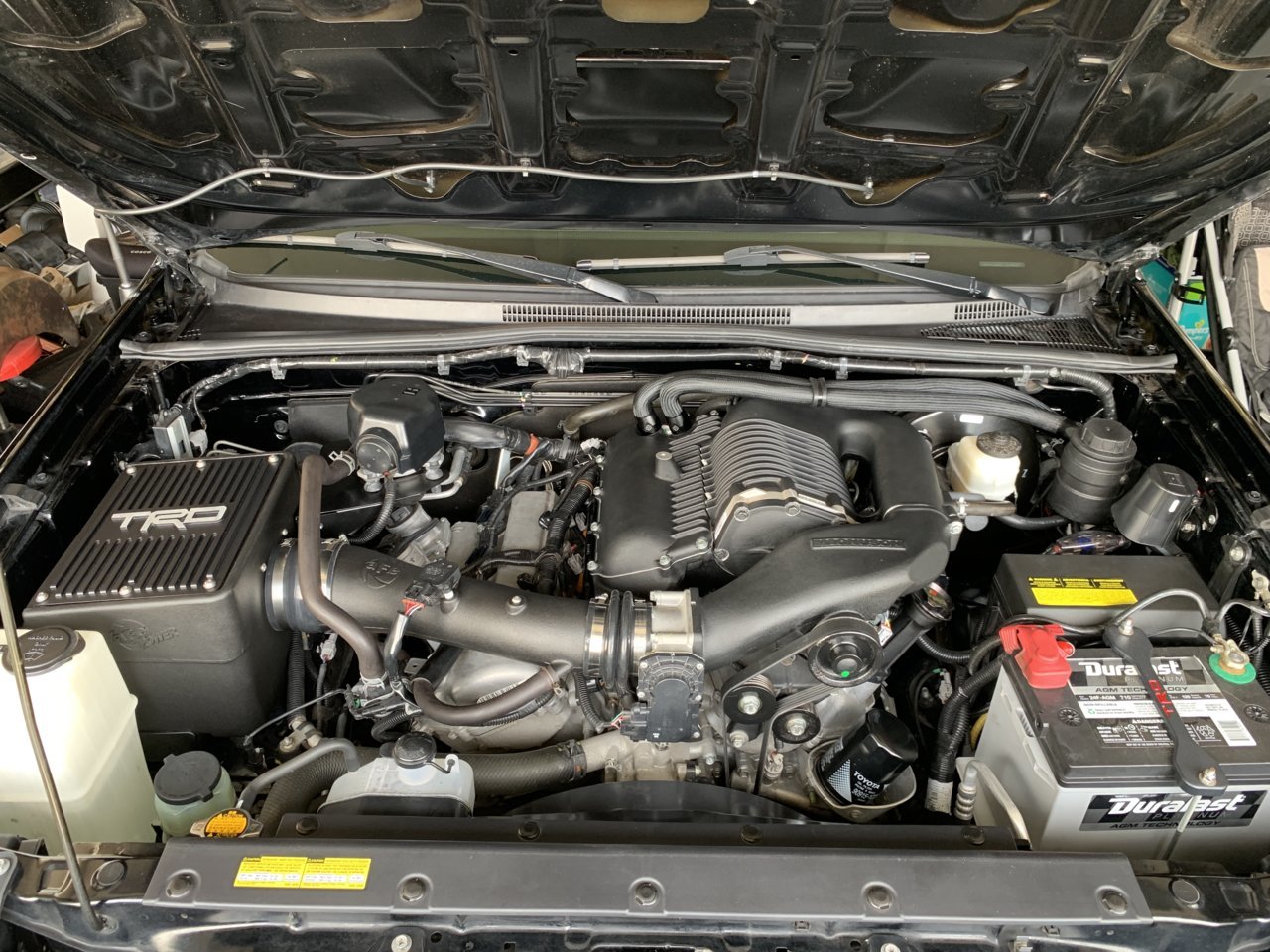

    Got my intake and @Coupe trd cover for some bling.

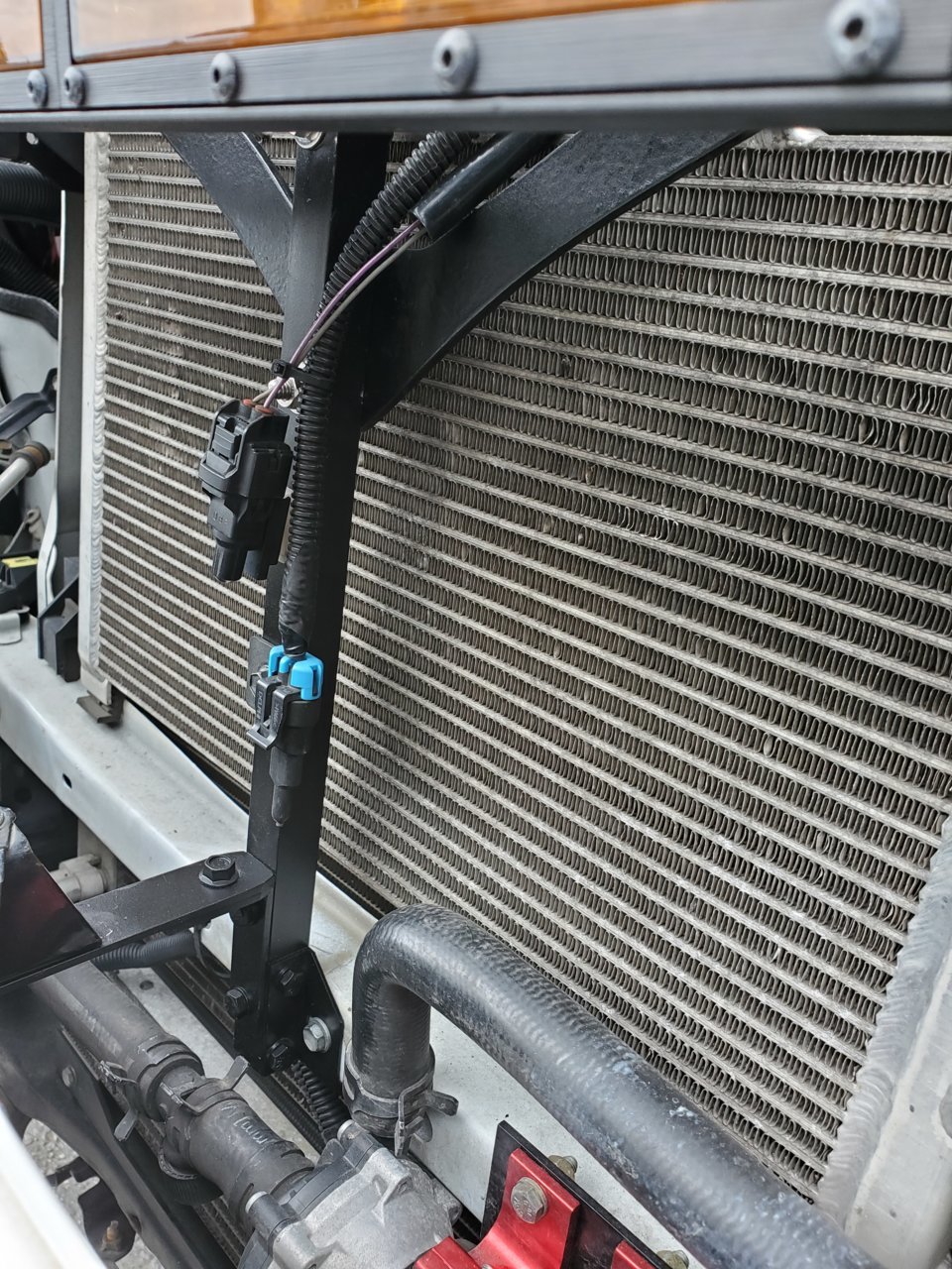

    i was tired of looking at the rusty radiator center support. best could do for free and no welder.20200405_161134.jpg

    Like it. Mr Coupe hooked me up a long time back. Love the look of that cover.
    Did you braid those coolant lines yourself? They look really sharp like that.

    Yeah I really happy how it came out. I used some Amazon 1” braid
    https://www.amazon.com/dp/B07K1X2XKC?psc=1&ref=ppx_pop_dt_b_product_details
    And some -an finishers https://www.ebay.com/itm/Z314-14AN-...Gear-Clamp-Fits-13-16-Hose-BLACK/142812566941
    12TRDTacoma[OP] likes this.

    Really nice. From the look of those finishers they have the clamp built-in so you swap them from the clamps that are on there, correct? I'll need to do this when I swap the coolant I guess.

    Yeah they have worn drive built into them. I positioned them so you cant see them.
