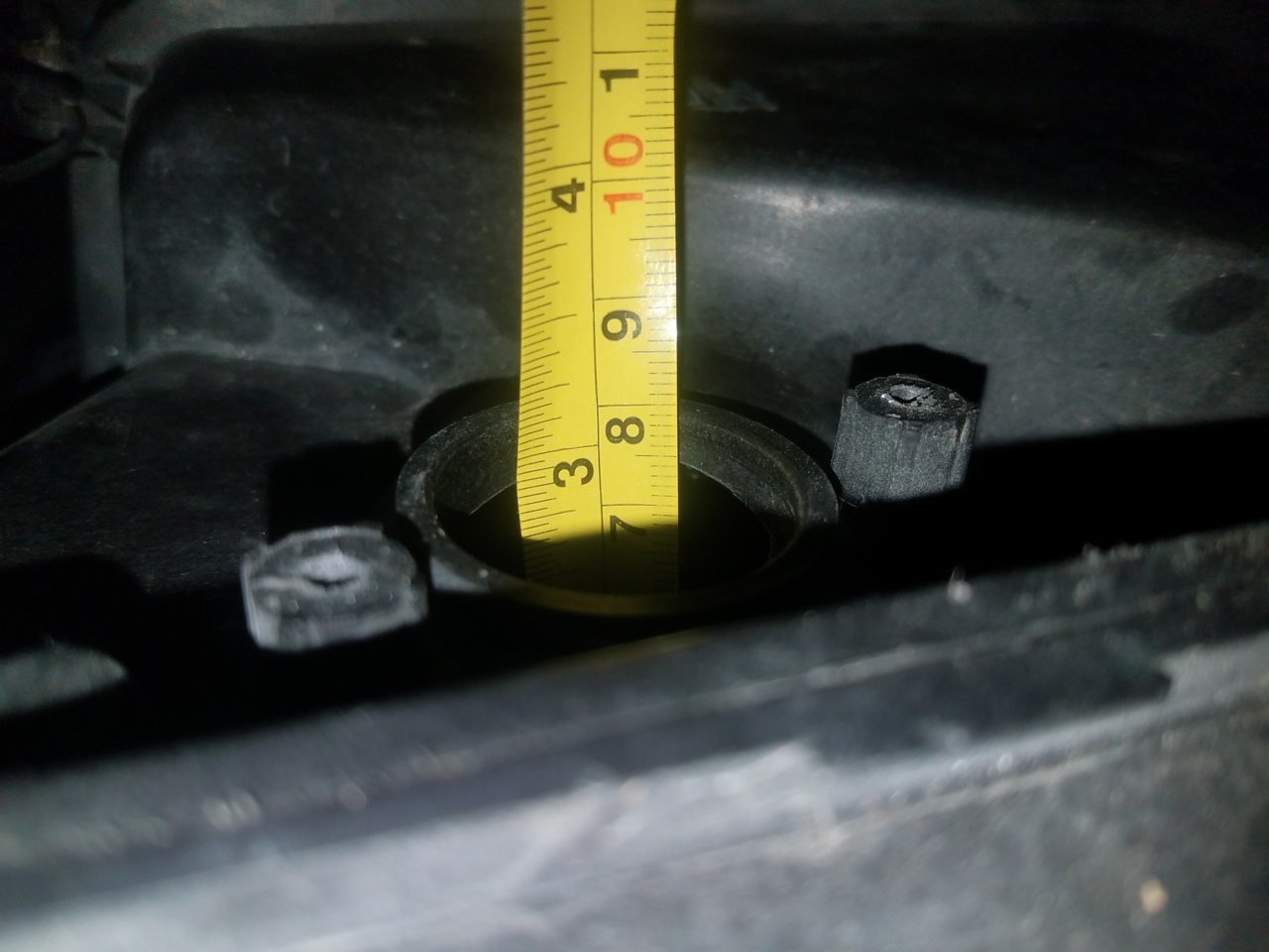

    It was just as I originally suspected. 2.75" @BillDaCat8
    The FJ/T4R tube offers approximately a size bump increase of .5" ID overall over stock OE Tacoma airbox applications.

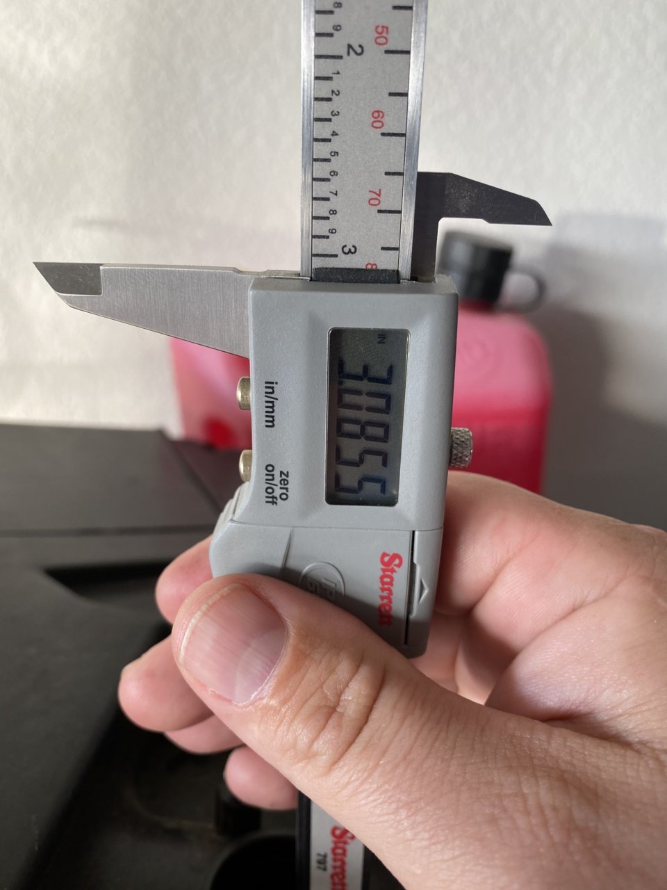

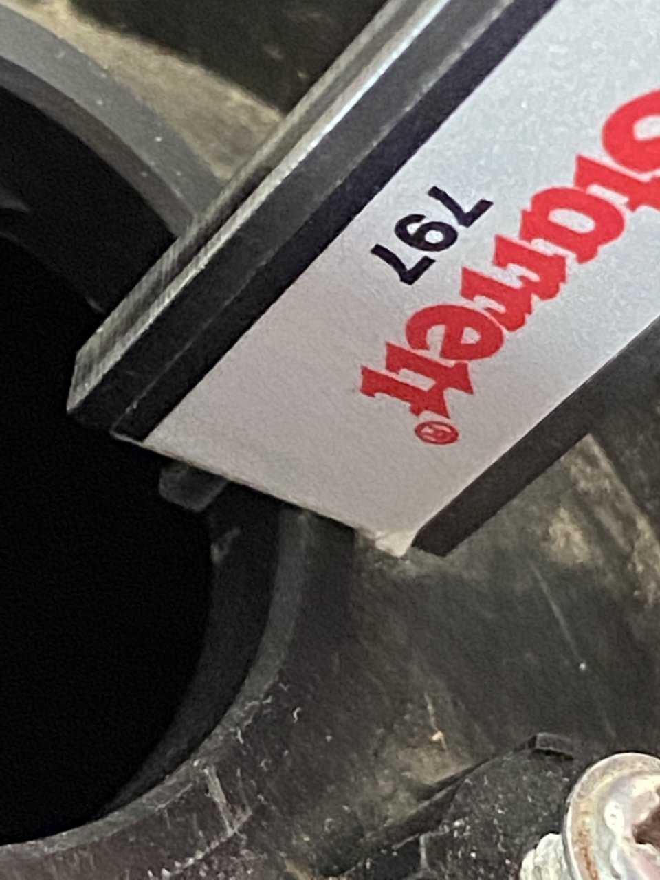

    OEM Airbox measures in at ~2.9550"
    This is the measurement of the actual diameter of the airflow tube inside the stock airbox. This does not account for material thickness. Just the internal ID.

    Taken with calipers? I was just using a tape measure on mine, so there was a lot of room for inaccuracy with my method.

    Starrett 797

    Am I wrong here?

    it’s the width of your measuring implement. You’re not reaching the true “bottom” of the MAF tube.
    3.0855-0.1255=2.9600

    I had a feeling. Okay that makes sense.
