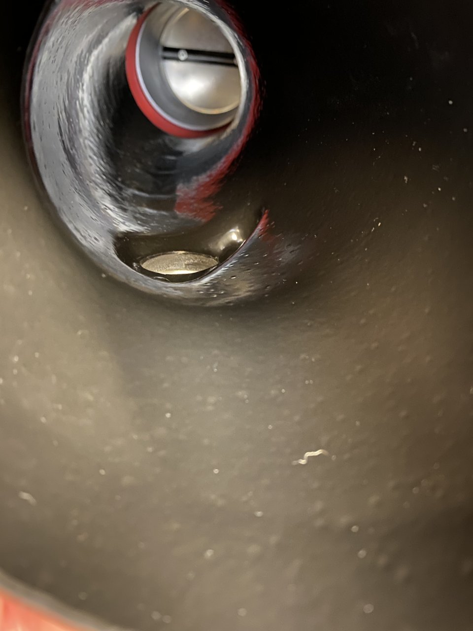

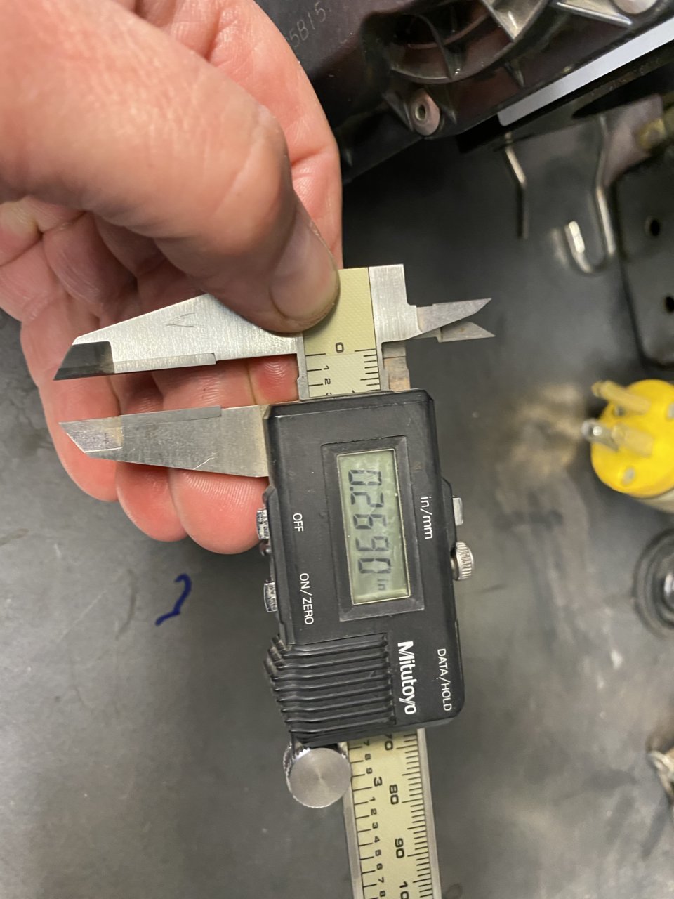

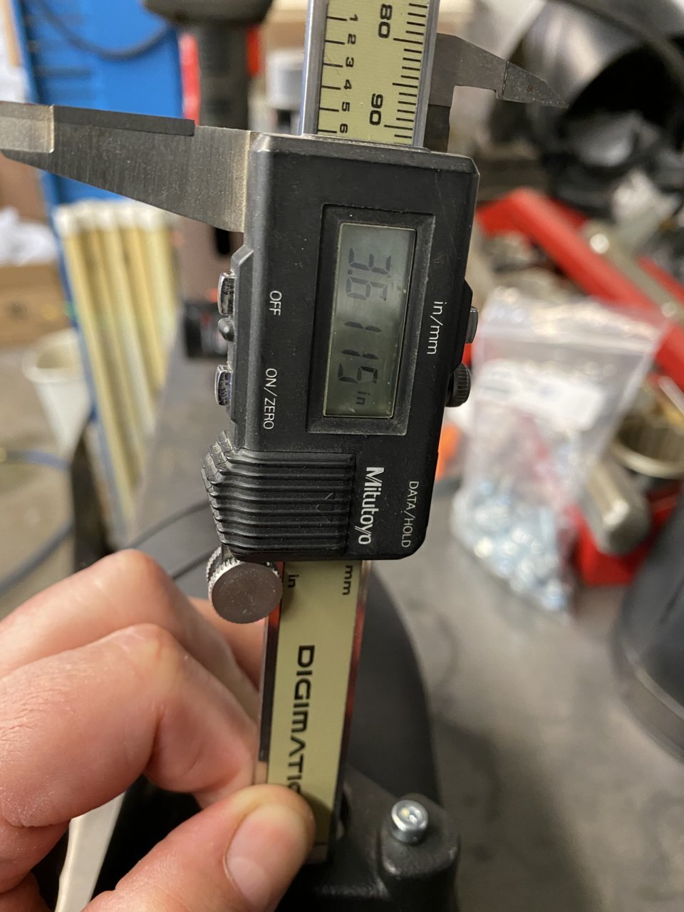

    A better, clearer headed look this morning yielded slightly different numbers. Viewed from inside the tube, the MAF is actually up into a bit of a depression. So, I used a small straight-edge across that opening and re-measured the takeaway. I get 0.43" so... 3.61" - .43" is 3.18" i.d.
    Stock Tacoma airbox opening 2.96"
    4Runner/FJ tube 3.18"
    So, .22" bigger. Let's call it a quarter inch.
    At least you get the larger opening at the throttle body end. I'm liking that part a lot.

    If you're calling it .22" and you convert that to metric, you get 5.588mm... I could see Toyota going 5mm bigger or 5.5mm.
