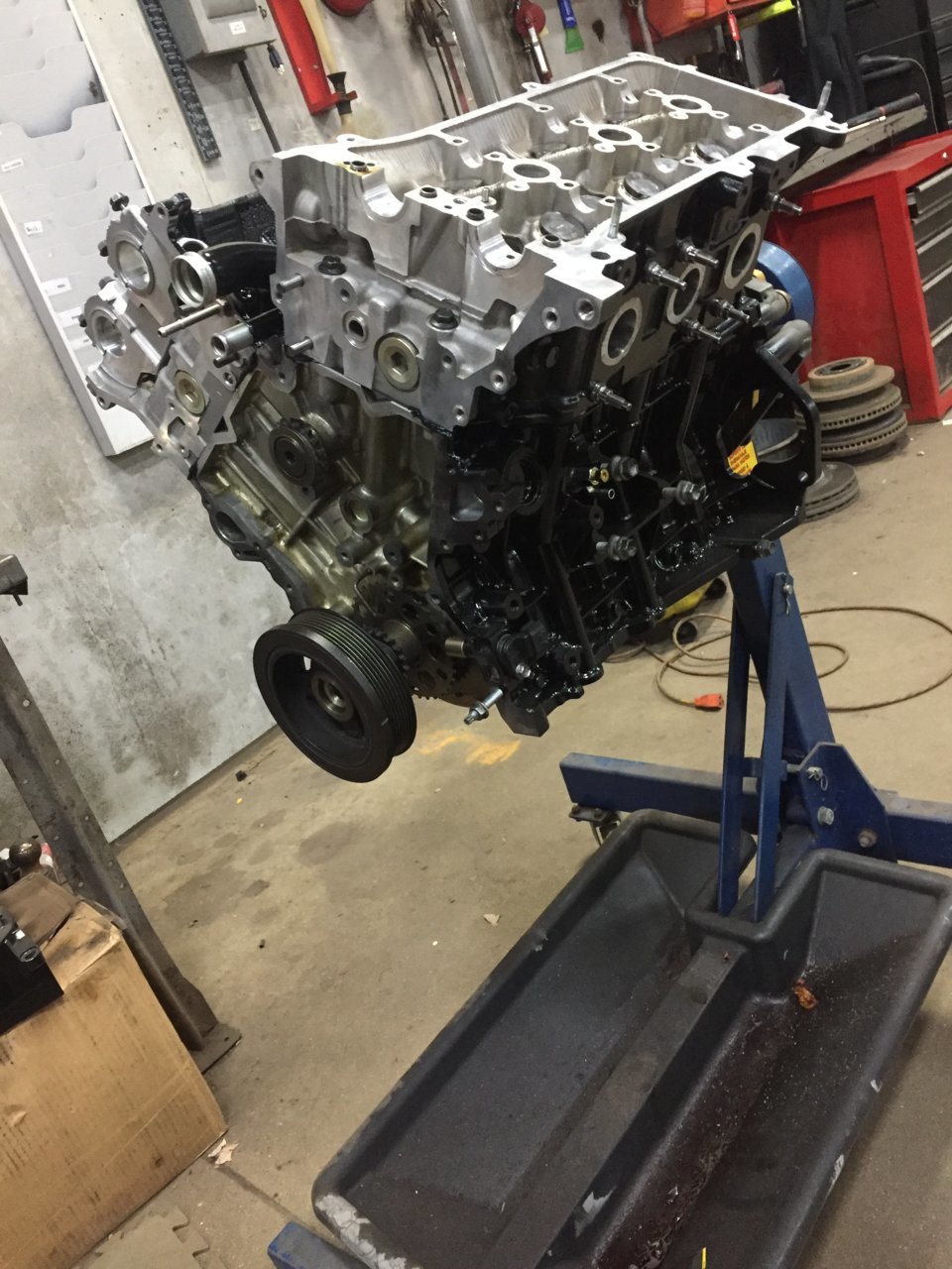

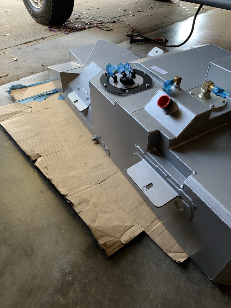

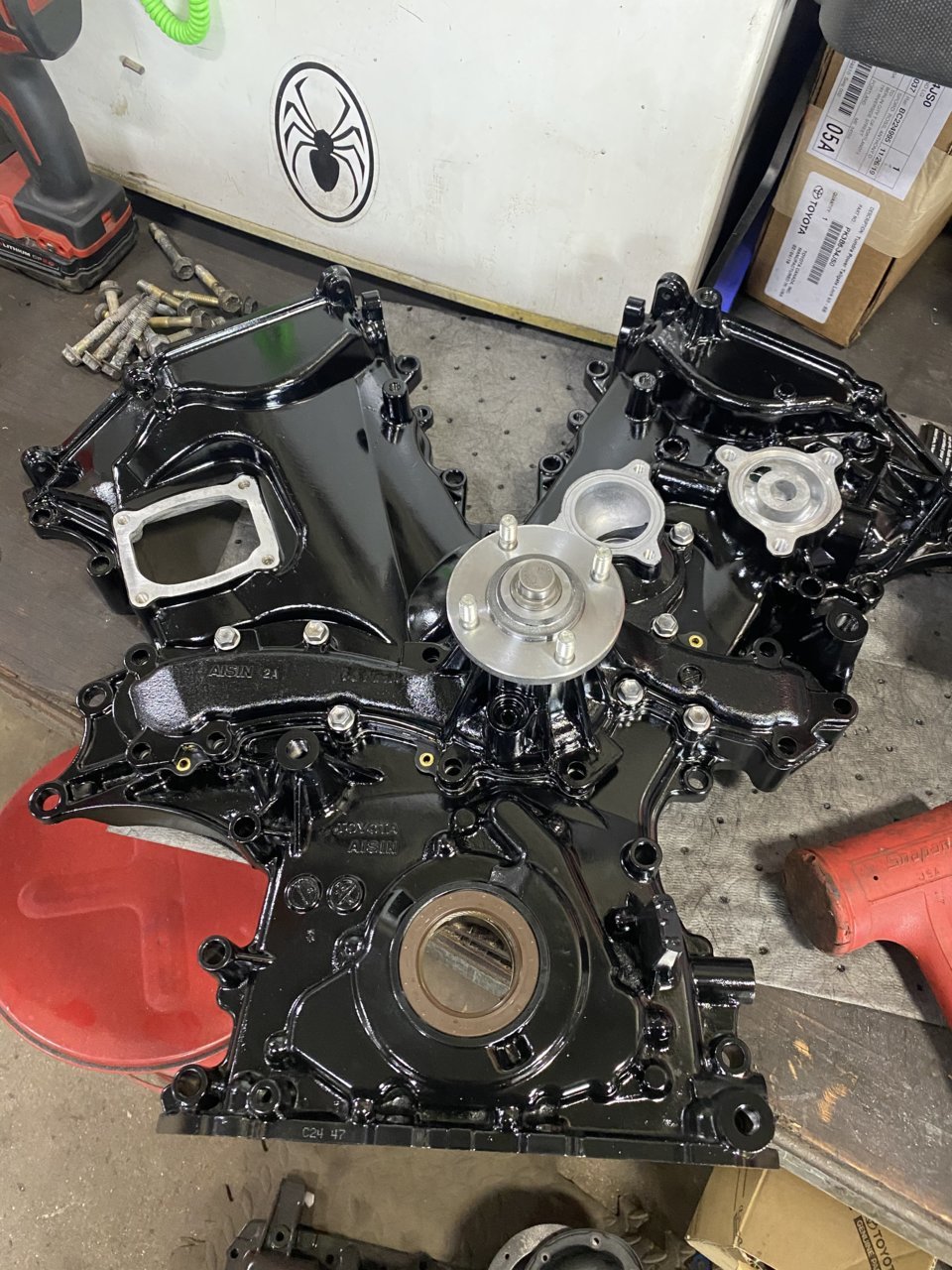

    9A02D415-0763-4EF1-93C3-CC744444546E.jpg Stuff is happening now. Cleaning every bit and bolt now. Takes a while.

    Purdy!

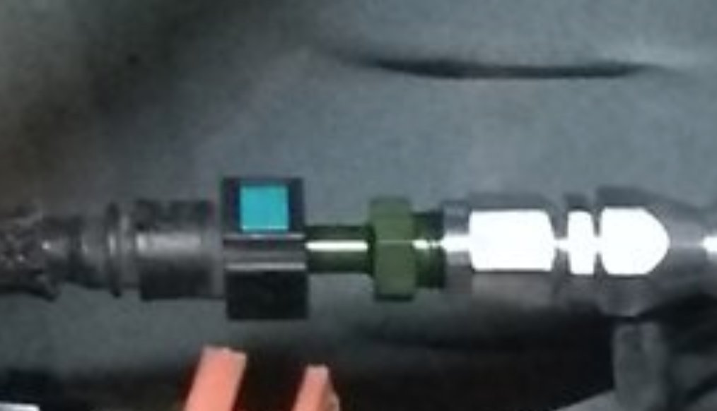

    Looks like your missing this one unless I read your post wrong.

    When I pull mine, I'll hit the rest of the block. Looking great!!! How much more time before you drop her in the truck?
    12TRDTacoma[OP] likes this.

    Quit a bit. Doing at work in between jobs. And want to do it right. I still gotta figure some stuff out once I get the motor in but I’ll be happy to just have it back in the truck.
    port polish the blower
    get pulley wrap mod figured out
    Gotta figure out my fuel filter like everyone’s doing right now I see.
    oil pressure gauge. Don’t wanna loose oil pressure on this motor now
    fan? Stock or maybe Electric
    Way more stuff I’m forgetting.
