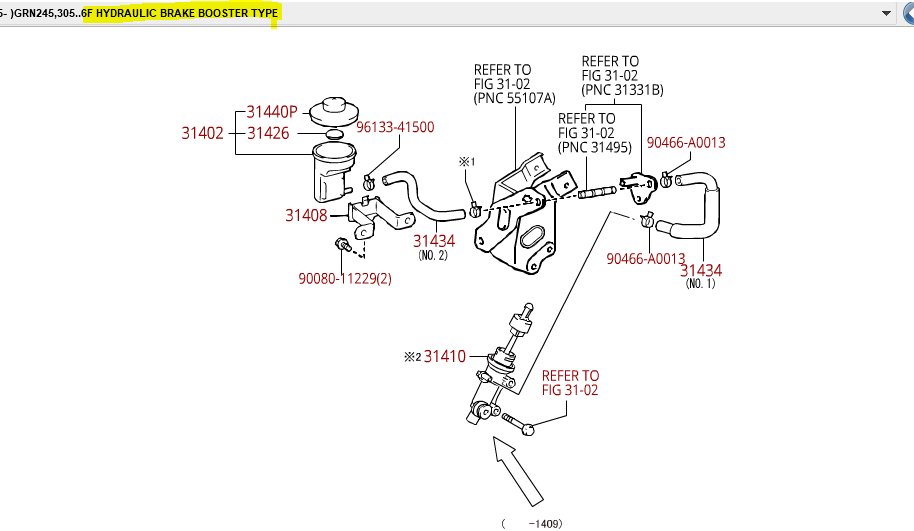

    Not sure if anyone answered this. But, yes. The brake master reservoir is also the clutch reservoir. The clutch portion is the front-most section and is divided internally to prevent a leaking clutch system from draining the entire thing. That would be bad.
    edit.
    Apparently trucks with all that traction control whiz bang fanciness get a separate clutch reservoir. Probably because their brake master cylinder/booster is drastically different.

  18. Apr 11, 2020 at 12:08 PM
    BillDaCat8
    BillDaCat8 Well-Known Member
    Jun 25, 2017
    #222348
    1,919
    Jake
    PHX
    07 4x4 Access Cab M/T
    My shit is all stock.
    Then you should have a separate reservoir for your clutch master like @Norton

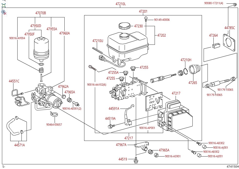

  19. Apr 11, 2020 at 12:45 PM
    BillDaCat8
    Jun 25, 2017
    #222348
    1,919
    Jake
    PHX
    I'm referring to the big ole honking hydraulic VSC/Atrac/whatever actuator.
    If you've got that setup, the clutch reservoir is remote.

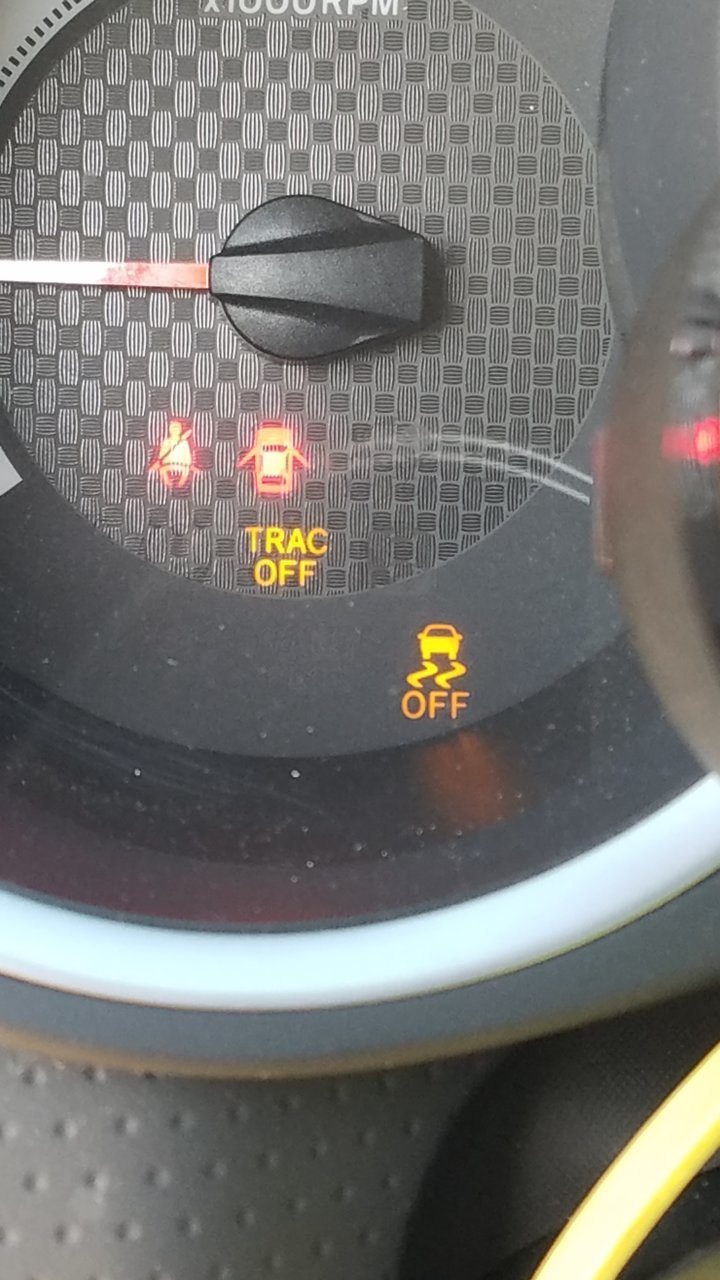

  20. Apr 11, 2020 at 4:53 PM
    TheFang
    TheFang No Big Deal
    Jul 15, 2014
    #133985
    2,643
    SoCal
    Tacoma TRD Sport
    TRD Exhaust, URD Short Shift, TRD Supercharger, Hellwig rear sway bar, TWM shift knob, limo tint, URD Y-pipe, URD LT Headers, URD Rear O2 Sim, Custom tube front and rear bumpers, LED spot pods, K&N CAI
    I could be way off and reading this wrong, but on my 2014 TRD Sport, I have the ability to turn on Auto LSD, and if I hold that button, it turns off what I read as traction control being turned off...
