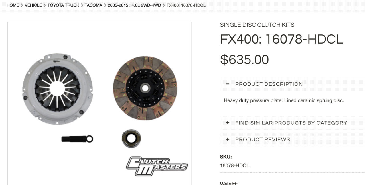

    What clutch did you run?

    To answer your question, the FX400
