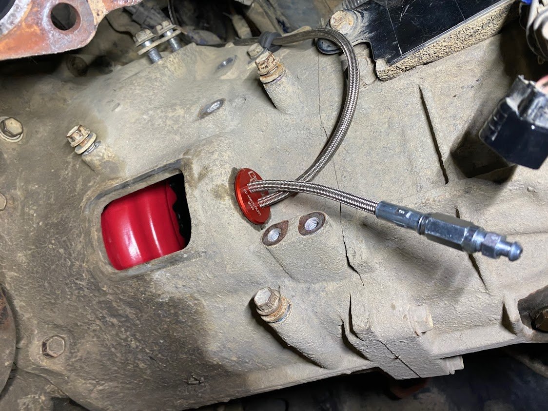

    I'm installing my Spec clutch, CM hydro TOB, and my URD lightweight flywheel this coming week.... Ill have to look into running the line all the way to the master.... Im ditching the accumulator.

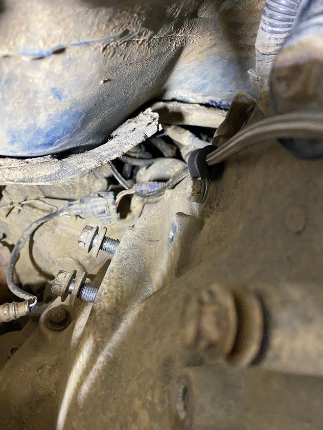

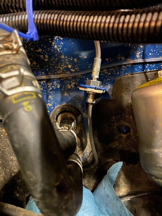

    6 gearT444E
    6 gearT444E Certified Electron Pusher
    Feb 3, 2018
    #243372
    7,779
    Deep South
    Herculiner Hootus
    Here's where I routed my line to, eliminated all the intermediate fittings. Basically goes from the master cyl directly to the bearing. Secured it to the side of the transmission with some of the stock bolts from the accumulator.
    The flywheel is P/N 13405-31081. If you want to buy a used one I have mine for sale, only 50k miles. Removed to install the URD heavy flywheel.

    It makes sense to take out all those sectional stock hard lines.
